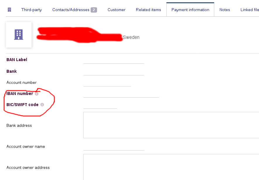

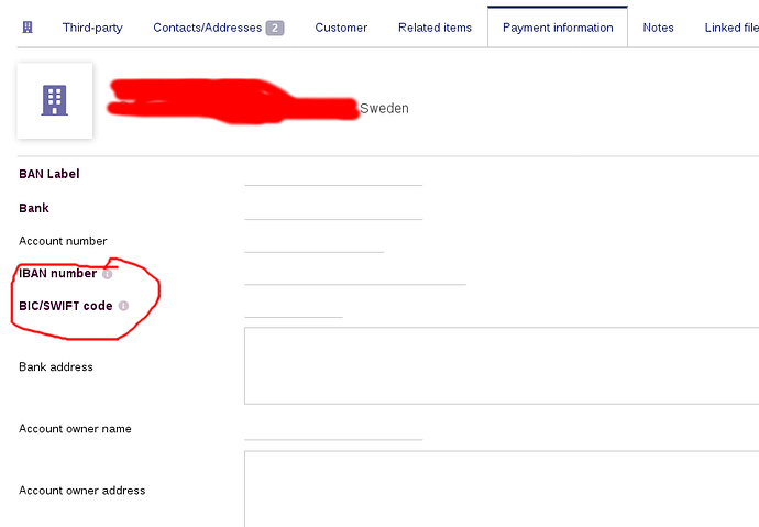

Dolibarr enforces the use of IBAN. How to disable?
Payments using IBAN is useful for exports, something we never do so we have no use for IBAN. Instead we (in Sweden) use something called “Bankgiro” which is sort of similiar to IBAN but only for domestic use.
However, when trying to enter Payment information (in Third party module) for a customer IBAN and BIC is required and we cannot find a setting to disable this requirement. How can we disable the enforcement of IBAN on a third party?
