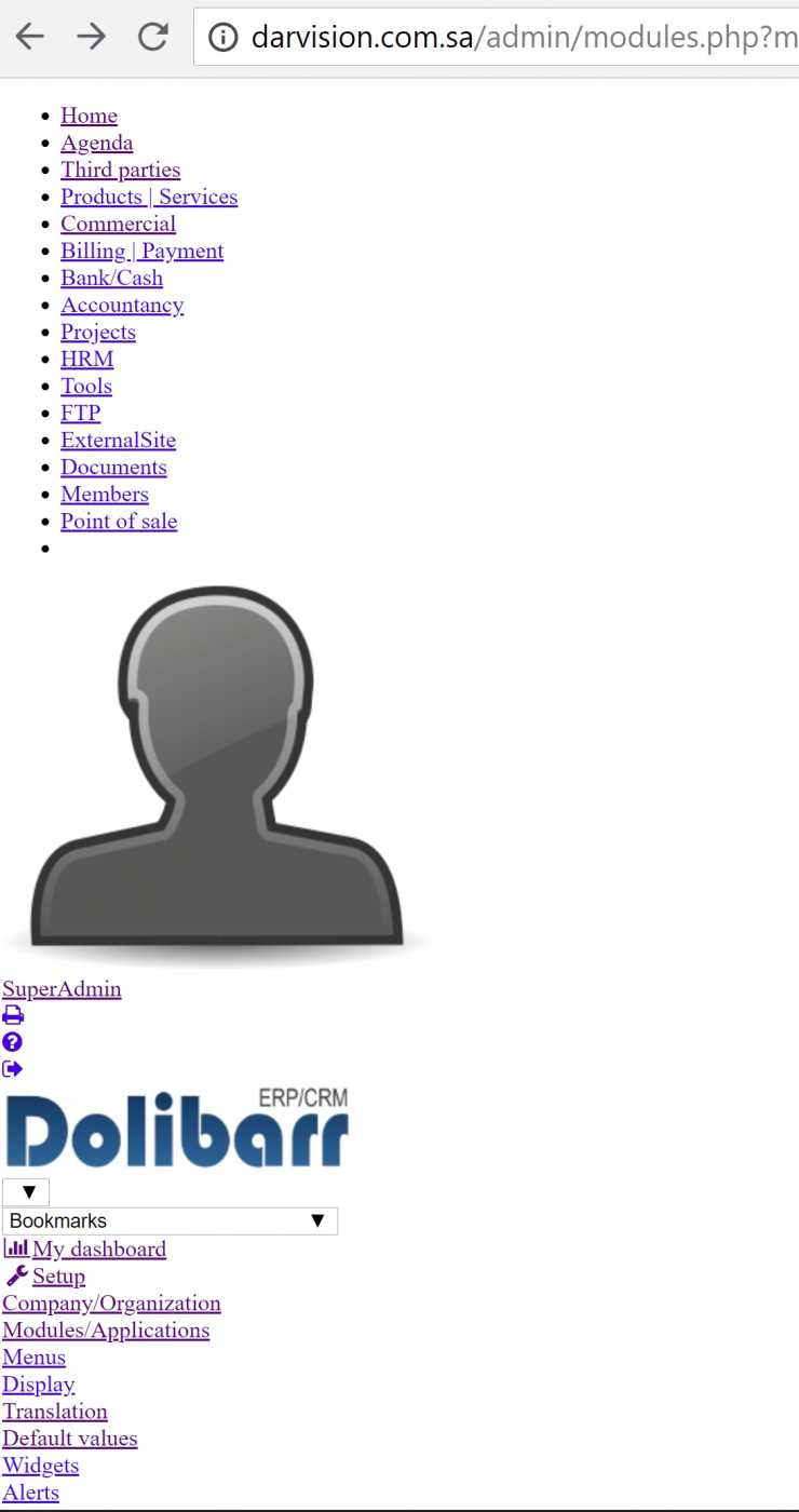

I just installed Dolibarr using CPanel and it looks without skin or style.
take a look at the attachments picture

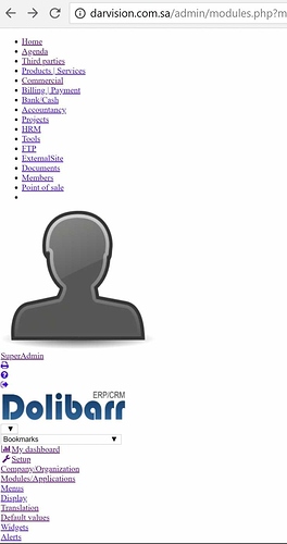

Loading failed for the <script> with source “http://darvision.com.sa/core/js/lib_head.js.php?lang=en_US&layout=classic&version=7.0.3”.
Check if this file exists in that location.
Also, if you manually uploaded the files, check the folder permissions.
It seems something is wrong in your web server setup because url http://darvision.com.sa/core/js/lib_head.js.php?lang=en_US&layout=classic&version=7.0.3 return error 500
Check the files were uploaded in binary mode and not text mode.
Check permissions were granted to the web server user.
Check also into your web server error.log file.

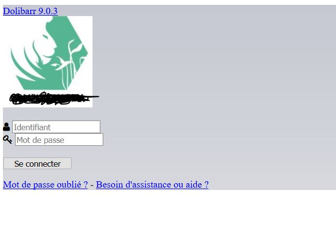

I have updated mine from 3.0.9 to 9 satble and I got the same issue.
Any idea would be welcome !
Leam
Hi LeamONade,
You need to progressively upgrade your Dolibarr from v3 to 4 to 5 etc.
That may help
