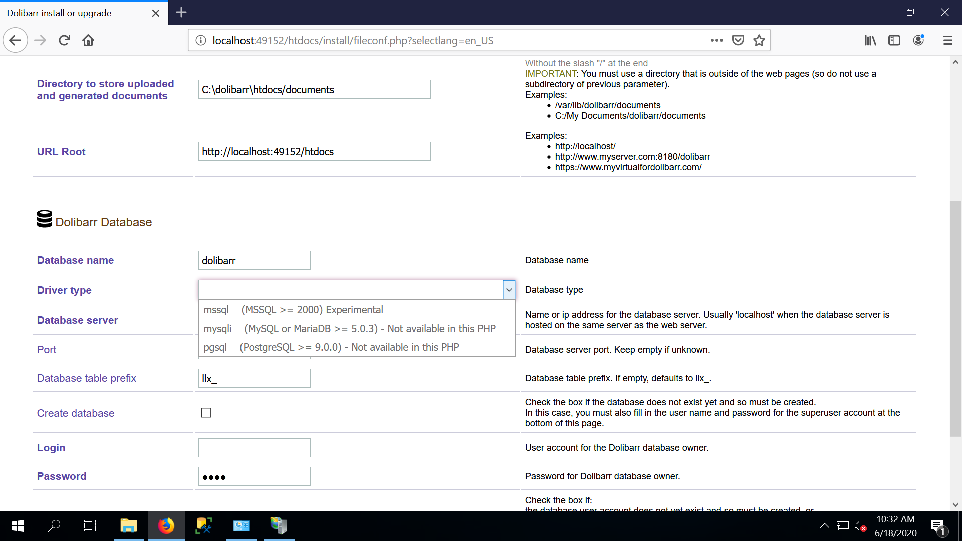

I was trying to Install Dolibarr 12 on MSSQL 2000, Yes It Works but It is not the way it works like Running on the New MYSQL Server. One Thing to note that MSSQL 2000 will only be running one Windows 2000, Windows 2003, Windows 2008 R2, as per my experience. It is not comparable with Dolibarr running on MYSQL 8.0.20., I understand that on MSSQL you can do a lot, like linking BRIO Query to MSSQL but I hope you will know that Running Windows 2003 OR Windows 2008 you will face the issue of PHP which is the essential core of Dolibarr.
So in my Conclusions: I will not sacrifice Dolibarr on MSSQL rather I would use MYSQL and run on Windows 2019 Server. But Dolibarr 12 is fine.
Sir, To where we can change the Code for the Installation instead of (mssql2000 experimental) we can change in to MSSQL 2019? so As for the Installation will Locate into MSSQL 2019
