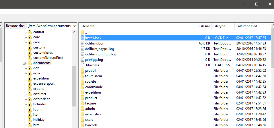

  3. Create a FILE in the ‘/documents’ directory and call it ‘install.lock’ as in the attached picture below:
Login as normal. Hope it helps.
