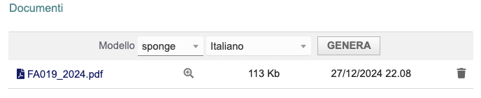

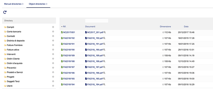

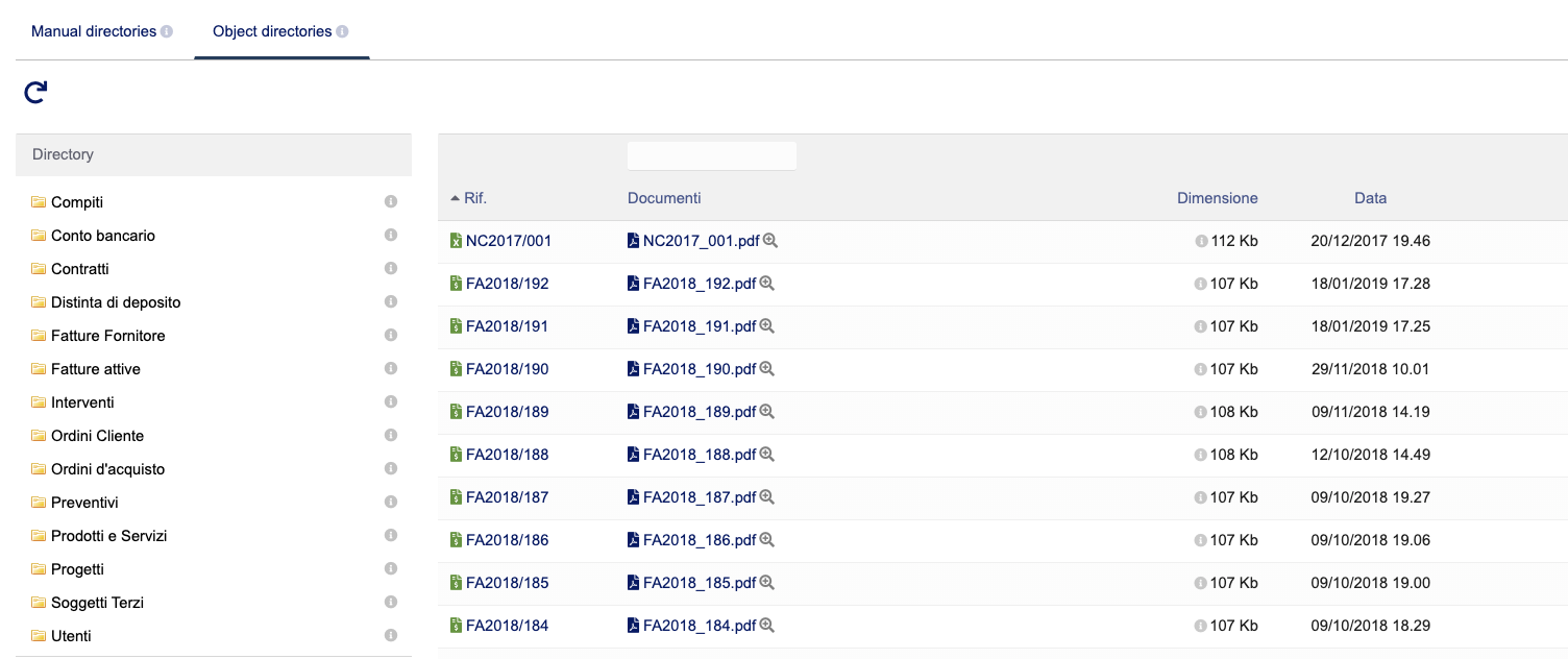

When I generate a PDF that file doesn’t show in the DSM/ECM module, but in the old versions of Dolibarr (before 12) it was working well.
I have just generate the new FILE, but there is no one in the DSM/ECM section.
And also in the server there is not the right folder.
I tried to solve it by checking the system settings, the folder parameters (maybe there is a parameter they don’t know that does this).
If, in the settings, in the invoice module, I try to generate a PDF with the DRAFT function, it is saved correctly in the right folder on the server as SPECIMEN.pdf
Thank you in advance for your support!

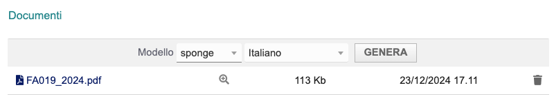

Hello, thank you for your reply.
In the server folders, there is not the folder and not the file .pdf
In Dolibarr application front-end I see the PDF in the Billing section, but not in the ECM module.
I think Dolibarr try to create the file, but it don’t find the right route or it can’t create the folder, but I try to change also the folder permissions from:
to
But nothing changed.
Thank you in advance for your help!

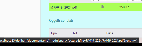

What is the URL displayed when you hover “FA019_2024.pdf”?
My local Dolibarr shows like this:
