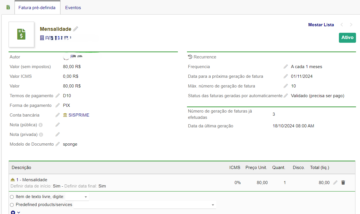

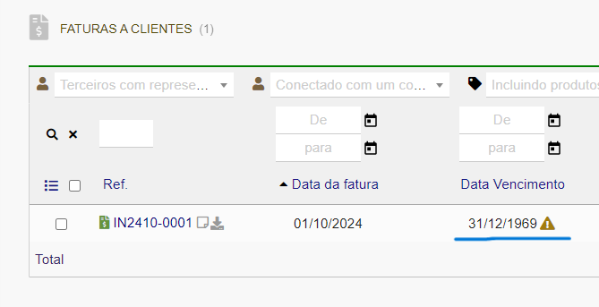

I’m having a problem generating pre-defined invoices, they are generated with the wrong due date and in the past. Has anyone experienced this and how they resolved it?

More data follows:
dolibarr version: 20.0;
type of installation
did this happen before?: The installation is new and this is the first time I have used the condition;

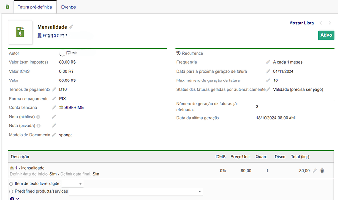

what are the parameters of the pre-defined invoice: below I send the printout of the parameters used
@rcagni, verifique na Configuração inicial, Configuração Dicionário - Termos de pagamento, pois provavelmente este termo D10 que você criou vai estar incorreto.
@rcagni, check the menu Initial Configuration, Dictionary Configuration - Payment Terms, as this D10 term that you created is probably incorrect.
