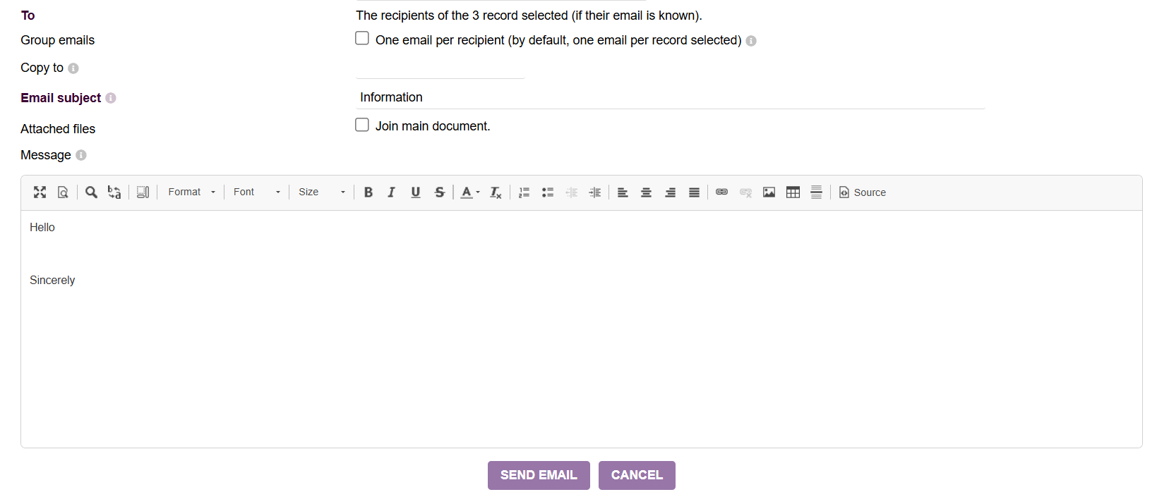

We have a new install of Dolibarr (v 22) and are planning to use it to manage a fundraising round. As I get ready to do some testing, I’m finding no way to attach a file to an email. Everything in the documentation and on the web tells me we should be able to upload and attach files from the local system, but there is no button or paperclip to do so. I’ve tried to attach a screen shot, but as a new user, I apparently can’t do that.
I’m certain I’m stuck on something really silly. I’ve scoured the module settings, and the same situation exists for general users and super admin. No button by the file list, no paperclip in the editor. Do I need a separate module to enable this functionality? It really seems I have a setting that’s turned off somewhere.

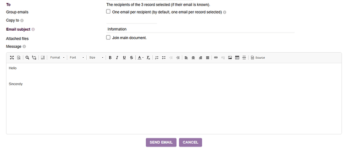

Do you have a screenshot @sabhain
and also - Welcome on board :slight_smile:
Thanks! See attached.
which page/url are this screenshot from @sabhain ?
@jonbendtsen This is from “Third Parties” where you can pick one or more contacts and then in the action pull down choose “Send by Email” .. it brings up this interface, which we want to use to start reaching out to contacts from within Dolibarr.
Thank you for your help!

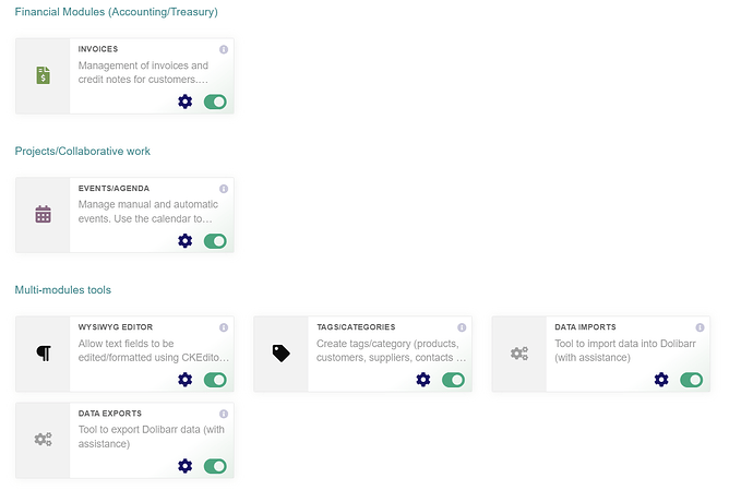

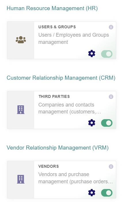

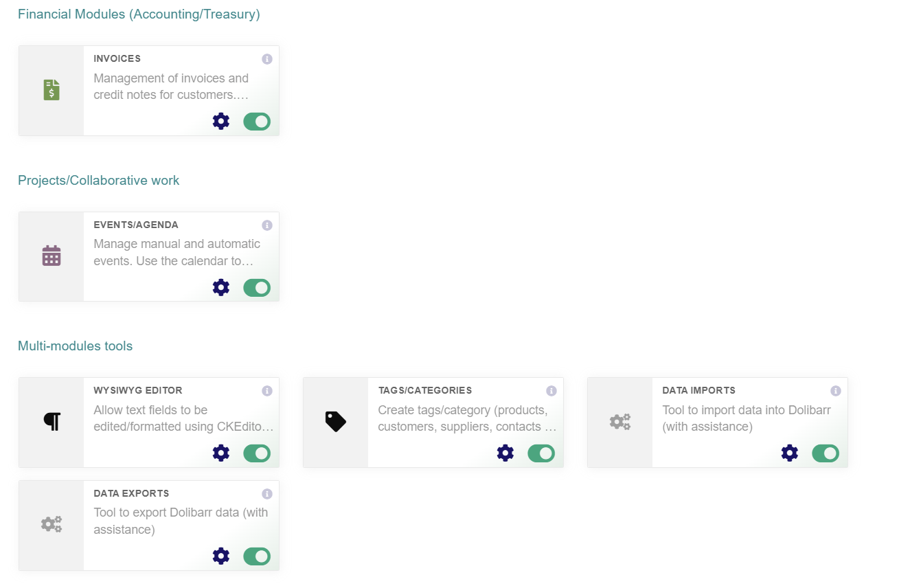

@sabhain which modules have you enabled?
@jonbendtsen
Not many .. just trying to use the CRM side for now.
I can’t see anything anywhere that represents an “Email Module” .. which I suspect would have more settings.

what about the documents module?
Yes, that is installed / activated and enabled for all users. I’ve uploaded test files to that, but find no way to select them for attachment.

I will say that we’ve discovered that if we go into a single Third Party and pick “send email” from there, then the “Pick Files to Attach” functions as expected.
So my challenge is in doing batch email to multiple third parties (from within the 3rd party module), I don’t appear to have the option to add or select files for attachment. To me, this is an essential function for a CRM, and the email dialog appears to have the spot for it, just no button to select / attach.

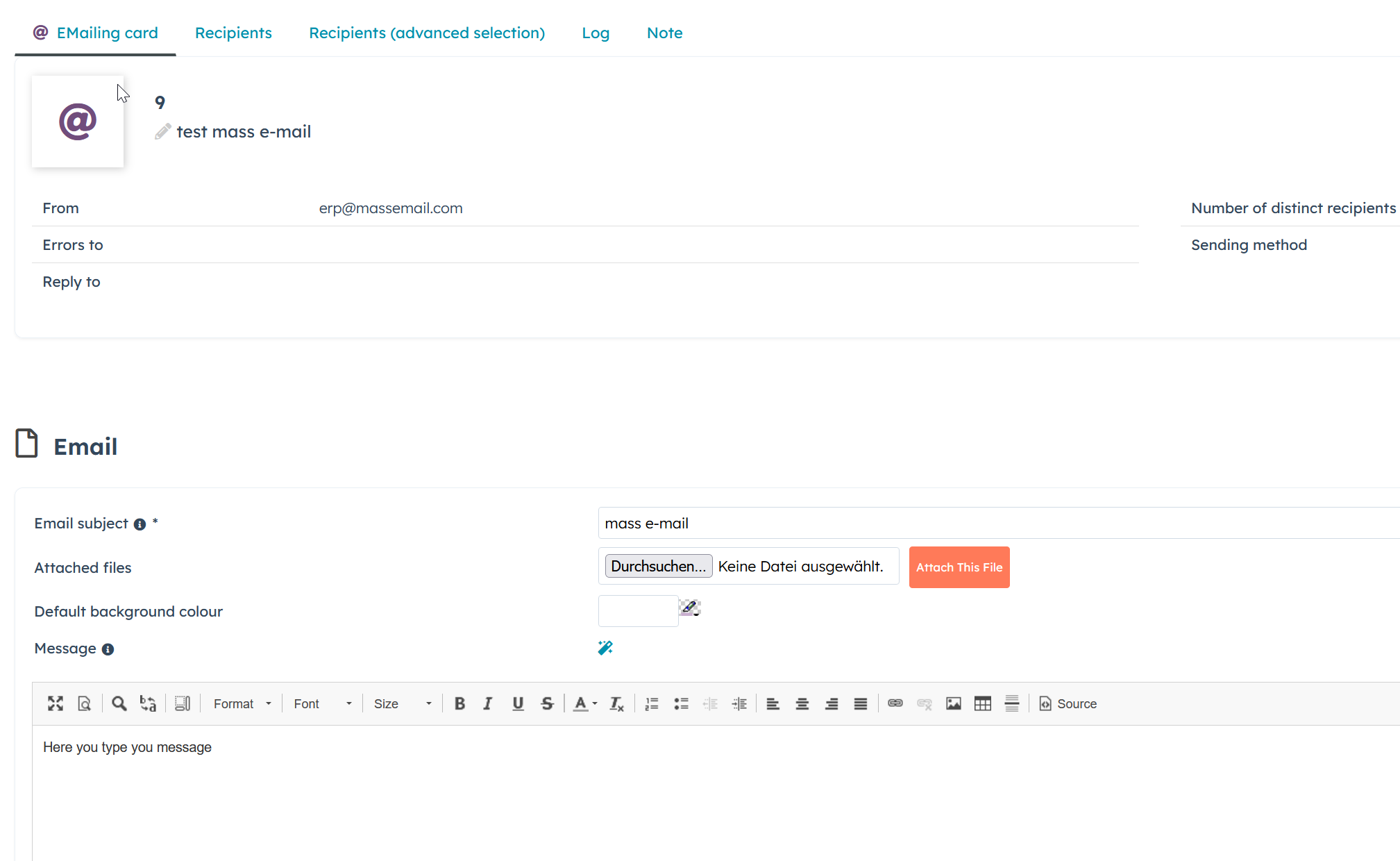

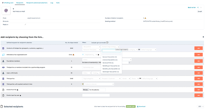

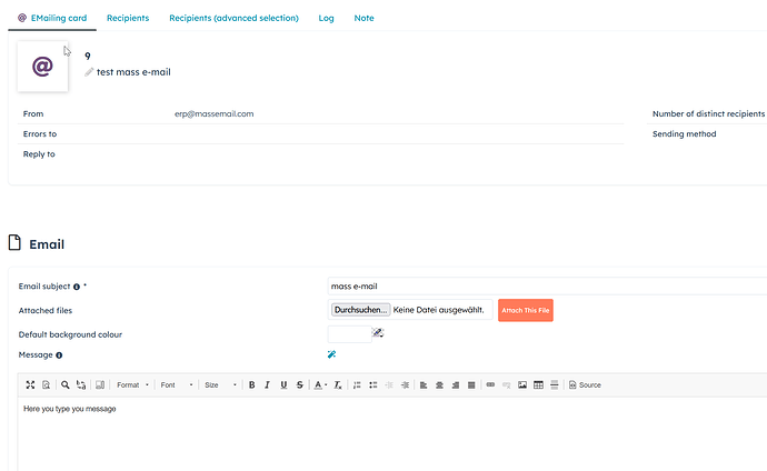

If you use instead the e-mail campaign under tools, there is an option to attach files and to do a fine grained selection of recipients.
Module e-mail campaigns must be activated and attachment functionality is a bit hidden - create the basic mail first, then go again into edit mode and there you can attache files.

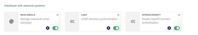

what you are describing sounds like the Mass-Emails Module.
At this standard module you an select/filter your third parties and run e-mail campaigns.

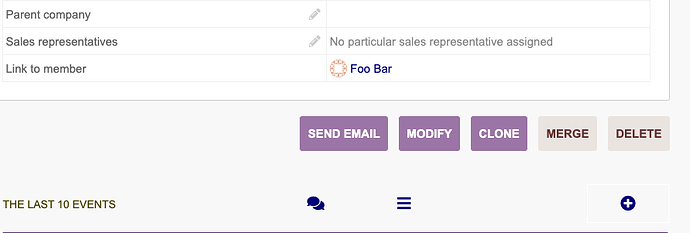

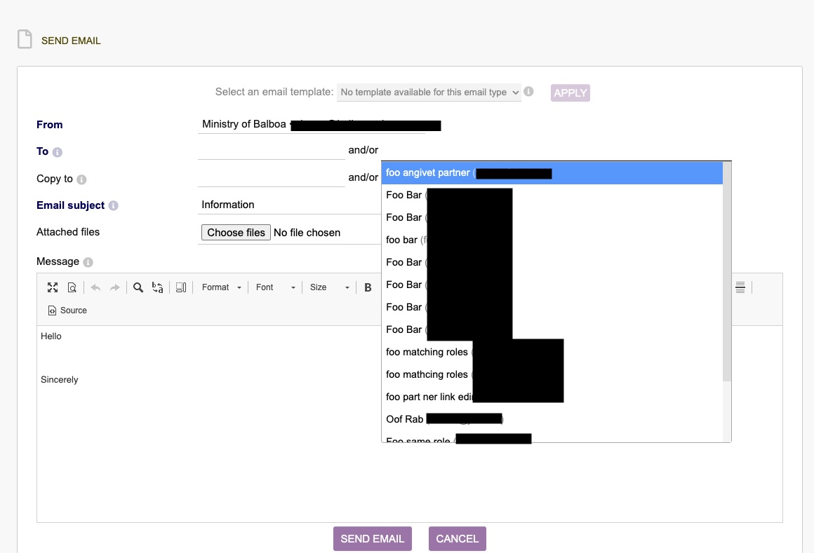

@sabhain
and that screenshot is from this address
/societe/card.php?socid=525&action=presend&mode=init#formmailbeforetitle
pressing the “Send mail” button
My production Dolibarr version is still 21.0.1, and my development and testing are not currently working due to a laptop breakdown :frowning:

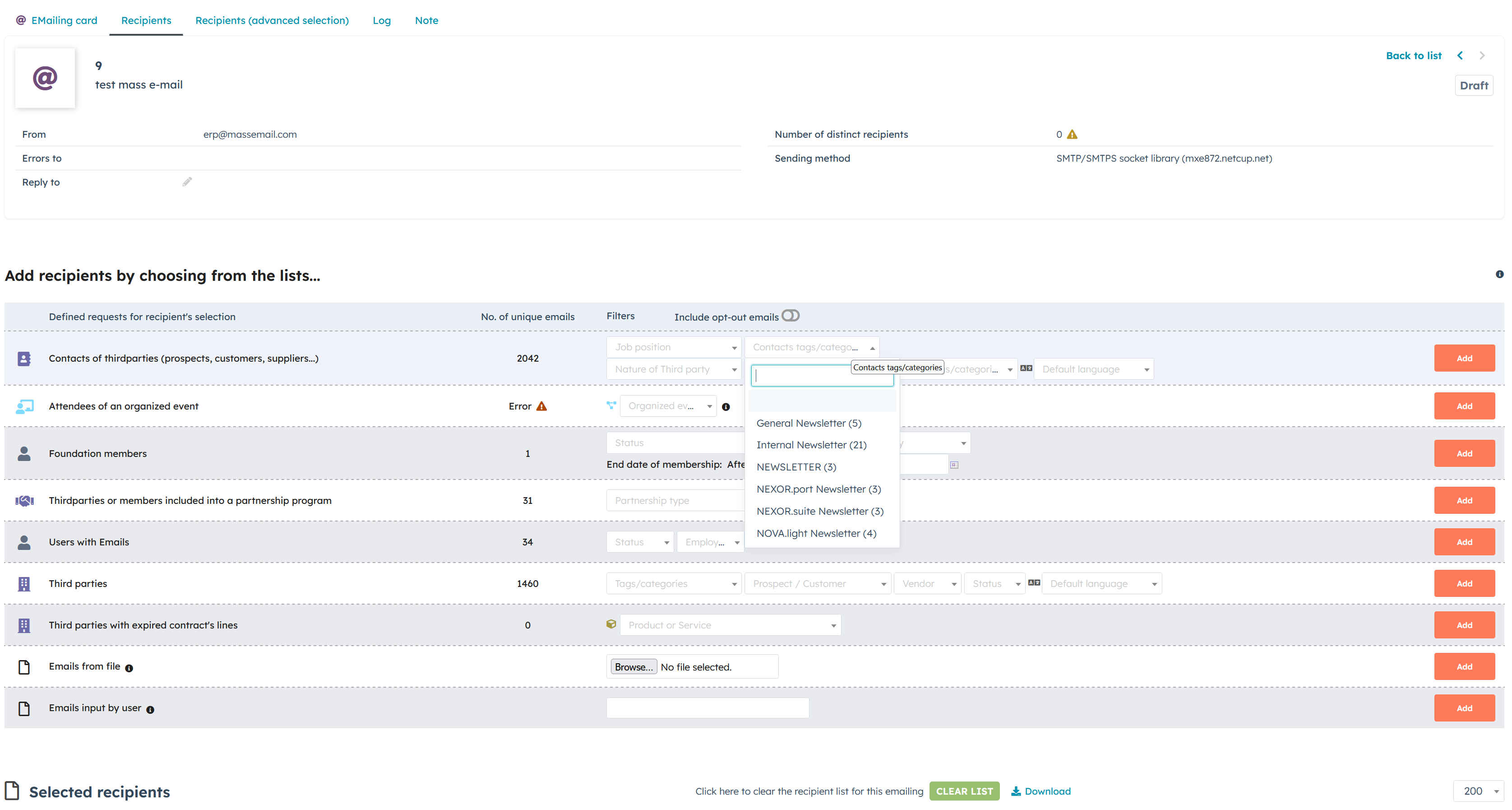

Hi everyone, I think this is getting me closer. The “mass emails” concept was helpful also. Perhaps I’m trying to go at this the wrong direction. What I have been trying to do is use the Third Party module to search and limit parties to the group I want to email .. and then picking email at the top.
It works great to send basic emails, but the attachment button just isn’t there. What @jonbendtsen shows also works for me, but it’s a single point email.
I’m working to try and understand the “Mass Email” module, but as I’m currently configured, it doesn’t give me the best control over how to sort and pick who the email is going to .. which Third Parties does.
Appreciate all the feedback, I’ll report back to what I find out shortly.
just as a hint: I am using TAGs to filter. So same of my contacts having the TAG: “NEWSLETTER”.
Within the Mass E-Mail Module you can select that TAG and have all that contacts as a recipient.
But this is only one way to filter. there is multiple others that work very well.
