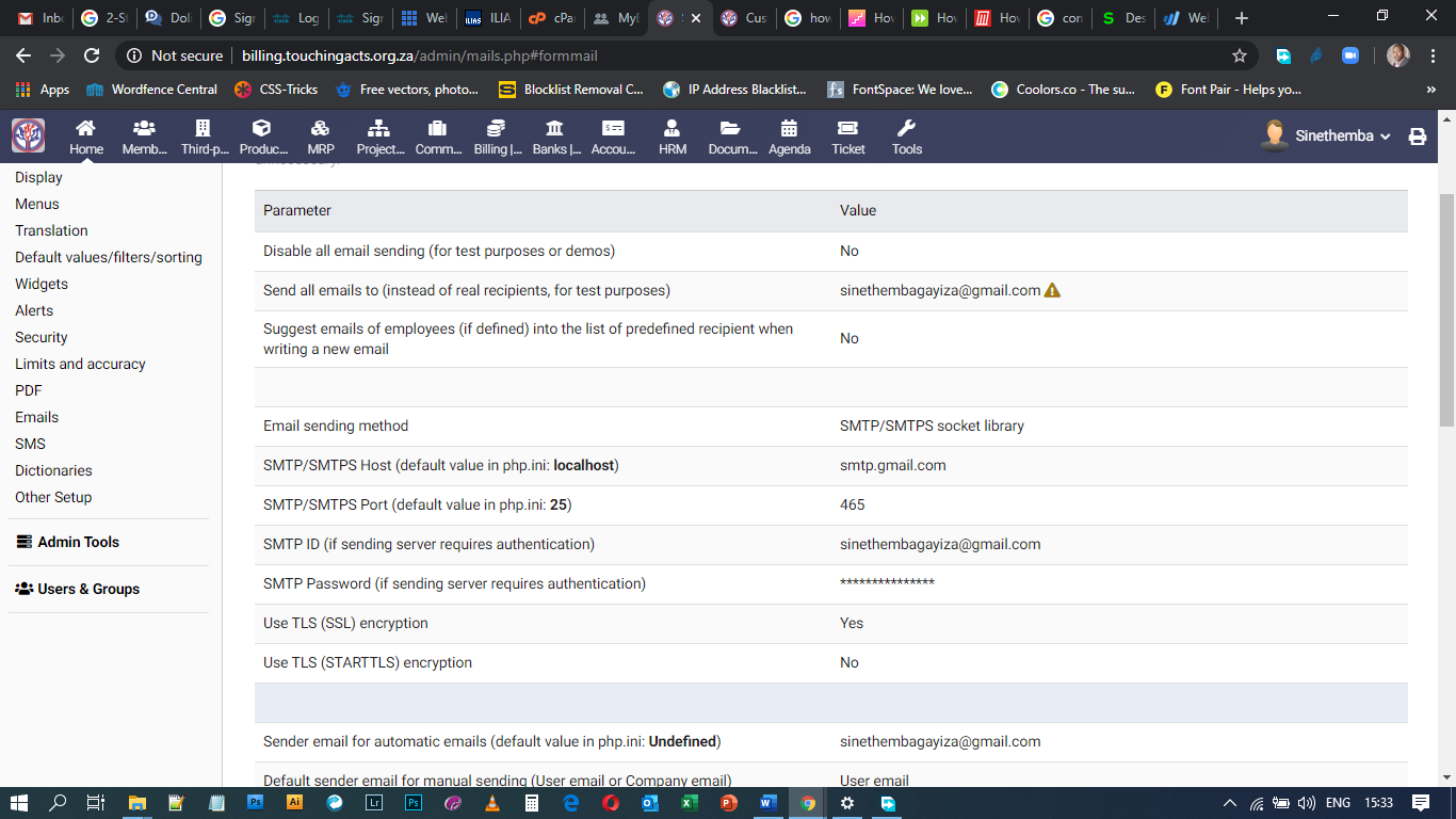

I attempted to setup gmail on latest Dolibarr installation and,
  1. I have enable less secure app on my Google Account.
  2. I also enable 2-step authentication but I did not receive any email linked to Dolibarr setup.
  3. This is the error I get:
    “Error [120]: Ran into problems sending Mail. Response: 534 5.7.9 https://support.google.com/mail/?p=InvalidSecondFactor q8sm2243363otc.53 - gsmtp Error [130]: Invalid Authentication Credentials.”
  4. These are settings
