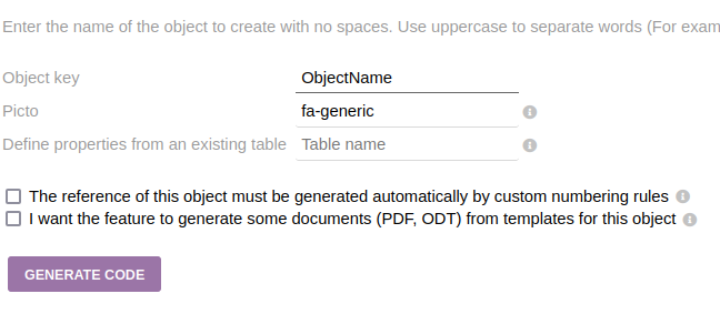

With Module Builder the development of modules is really simple. When creating an object inside a custom module, it is possible to check a box to automatically generate automatic numbering.
I have several objects that I have already created for which I have not checked automatic numbering. Now I would need to enable it but I don’t want to delete the objects I have made and redo them with the checkmark.
Is it possible to enable it from already created object? Is it sufficient to create the file mod_objname_standard.php in htdocs/custom/modulename/core/modules/modulename/ and modify it as desired?
