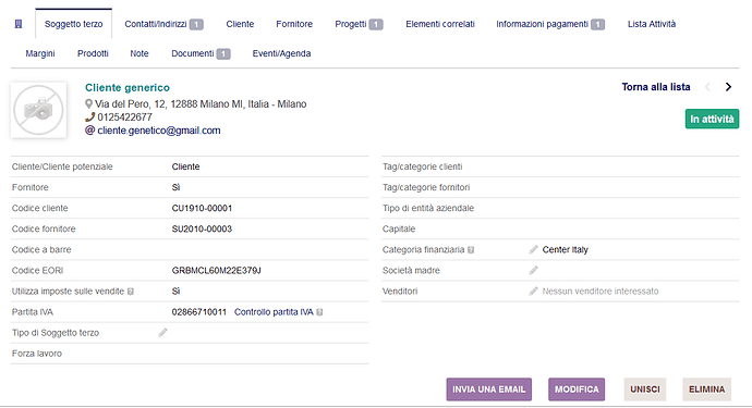

I solved :slight_smile:
in the it_IT \ companies.lag file there was the string “ProfId3IT” with value ‘-’.
By inserting the value “Codice Fiscale” the field appeared.
Thank you!

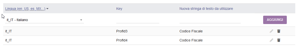

Better to use the translation menu than doing the modification directly in the file.
Next update, modification will be erased
in the tansaltion menu i cannot see the ProfId3IT vaue, furthermore, are you sure the .langs file will be overwritten?
Yes, each upgrade you overwrite langs file.
