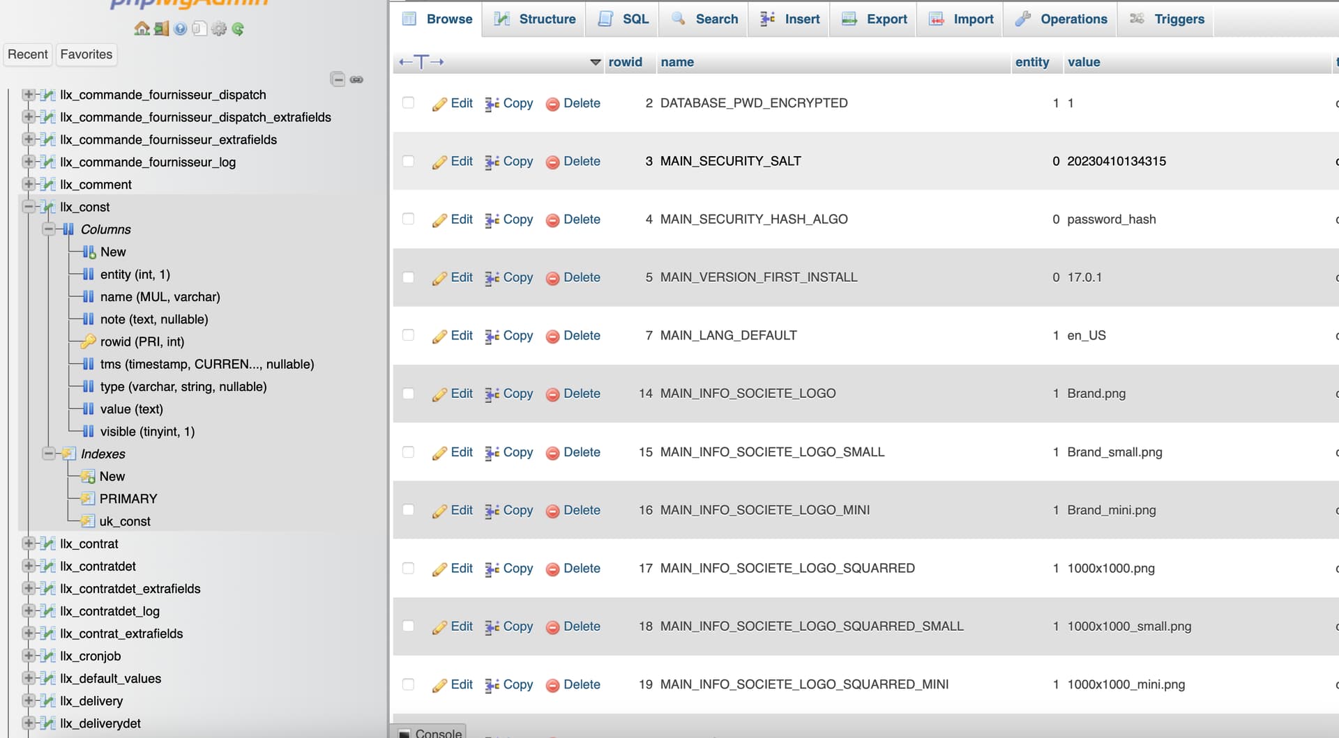

I am new to Dolibarr, and in the process of setting up my install v17.0.1, and after I enabled the CAPTCHA security code feature, I can’t log in anymore. How do I disable the feature on the backend? Also is a better way like OTP/2FA access available, with backup codes for access?
The error: Bad value for security code. Try again with new value…
Search of a key that contain ‘CAPTCHA’ on table llx_const and put it at 0.
I just searched in llx_const and do not see it
Nevermind found it. It’s been a while since I’ve used this tool.
If anyone else comes across this issue and uses PHPMyAdmin, use the arrows, it was on page 7 and the value was “MAIN_SECURITY_ENABLECAPTCHA” 1 1 (changed it to 0 0)
The key is MAIN_SECURITY_ENABLECAPTCHA
Thanks again, I had found it.
does it solve your problem? i set it to 0 0 but still asking for the security code… so stress
Remove all entries in llx_const with name that start with MAIN_SECURITY_ENABLECAPTCHA
