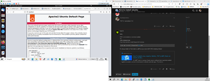

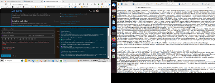

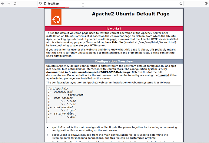

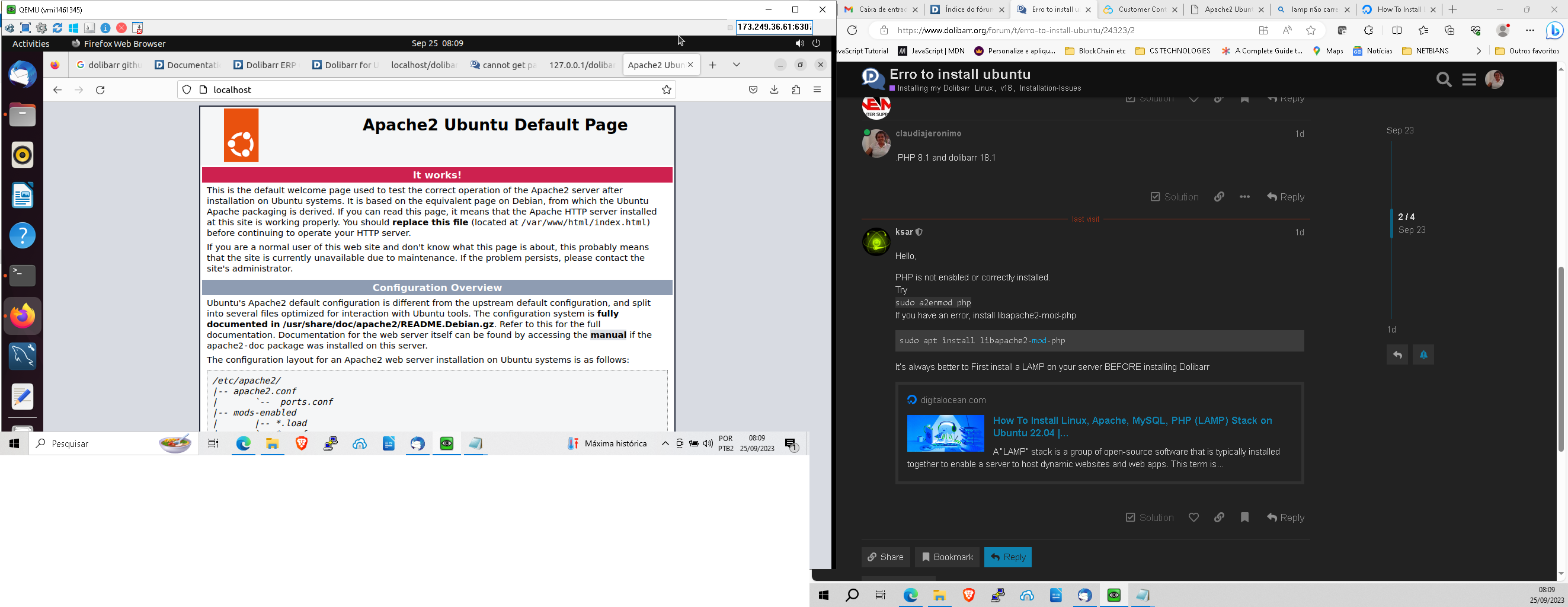

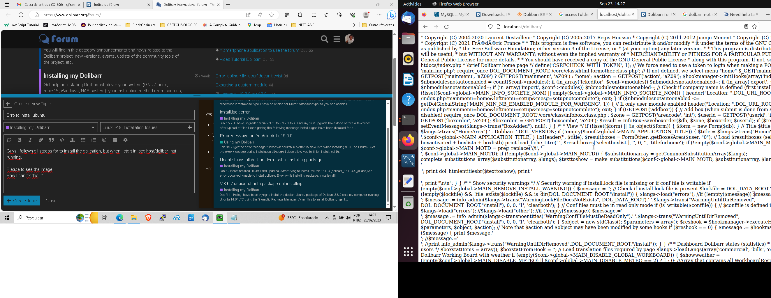

Guys I follown all steeps for to install the aplication, but when I start in localhost/dolibar not running.
How I can fix this. ?

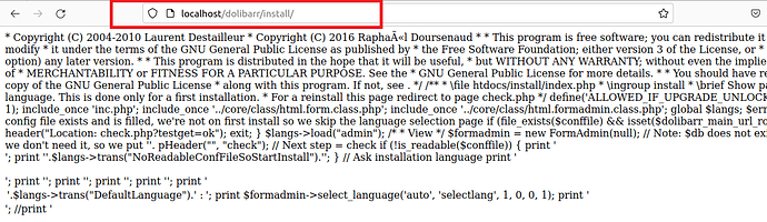

PHP is not enabled or correctly installed.
Try
sudo a2enmod php
If you have an error, install libapache2-mod-php
sudo apt install libapache2-mod-php

Hello dar, thank you, but the apache is ruuning
when I try localhost/dolibarr not show instalations page. I will try the reinstall server.
After reinstall lamp server
As explained above, Apache is running yes, but PHP Module is not enabled in Apache.
