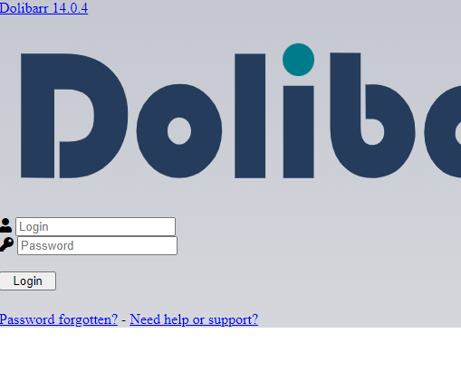

Hello all. After “sucessfull” instalation dolibarr on the our hosting provider with domain redirection i’m recieving following error:
Warning: require_once(filefunc.inc.php): failed to open stream: No such file or directory in /main.inc.php on line 250
Fatal error: require_once(): Failed opening required ‘filefunc.inc.php’ (include_path=’//htdocs’) in /main.inc.php on line 250
But when im usin’ server name for installation purposes everthing works fine.
PHP is 5.6
Login promt is also a little bit broken:
obraz

Ok, i’ve figured this out by myself. Issue has been caused by dots in the directory name.
