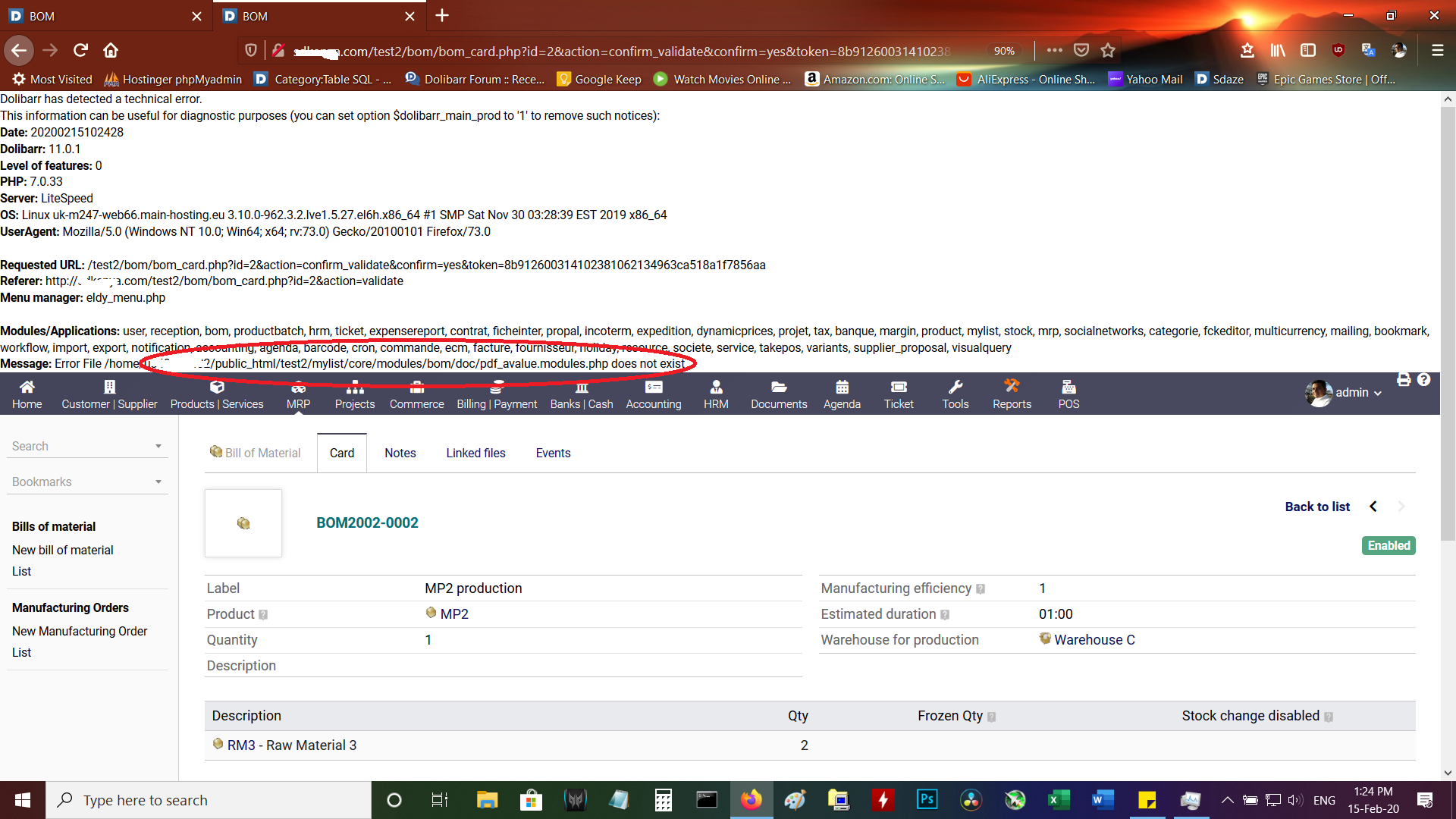

I have a strange issue when validating a BOM:
As you can see from the picture, the error is due to pdf_avalue.modules.php not existing and furthermore it is looking in a folder called mylist. mylist is a module that I have installed for reports from the Dollistore. mylist folder does not exist in the test2 root folder but exists in the custom folder as it is an addon module. Also I have noticed that core/modules/bom/doc/pdf_avalue.modules.pdf does not exist in the default download of v11.01.
