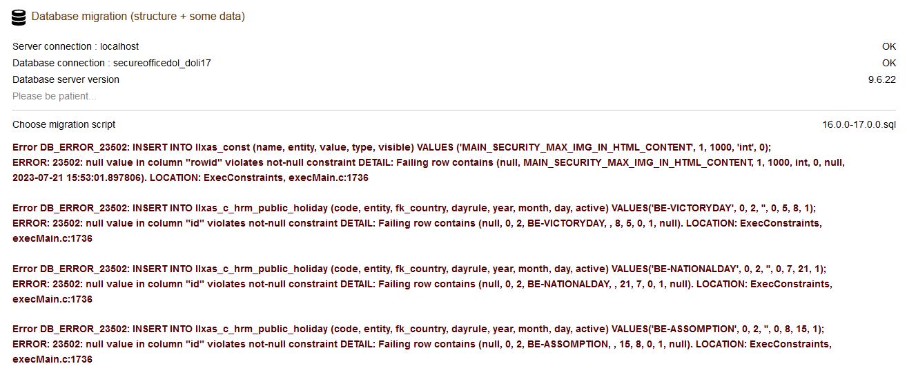

But we had several errors on the Upgrade Wizard:
Attached complete list of errors.
upgrade_errors.txt (68.3 KB)

all INSERT operations fail because some AUTO_INCREMENT fields are not set automatically and remain NULL.
Difficult to understand what is happening, but it seems to me a database setting problem
