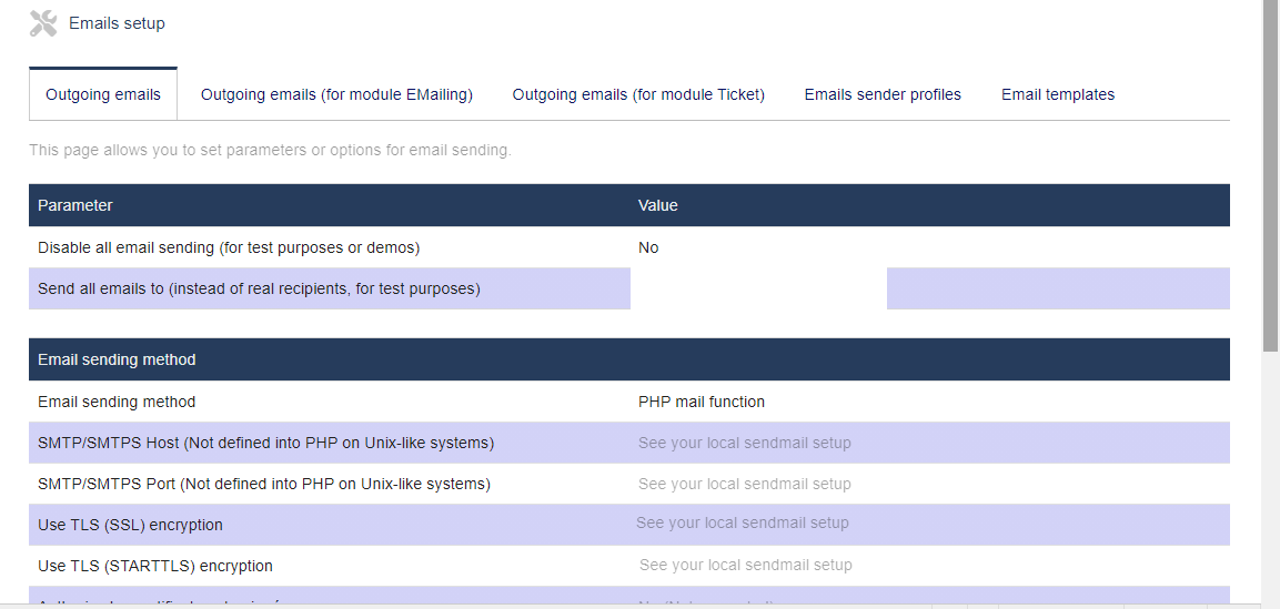

Hi
Can you check configuration and test mail in your Setup > Emails > Emails Setup
Tweak php.ini in case of any requirements.
If mails go from ERP, then I guess your config in Admin Tools > Scheduled Jobs must work.

Hello.
yes, test emails are working. Direct access to the .php file via URL also. The problem is with the cronjobs. The return (in most cases) is the login screen for Dolibarr.
