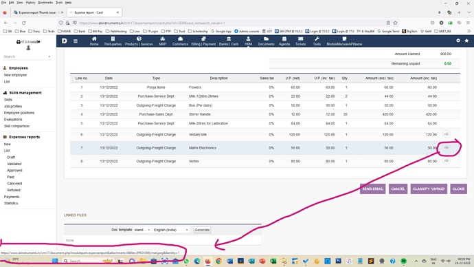

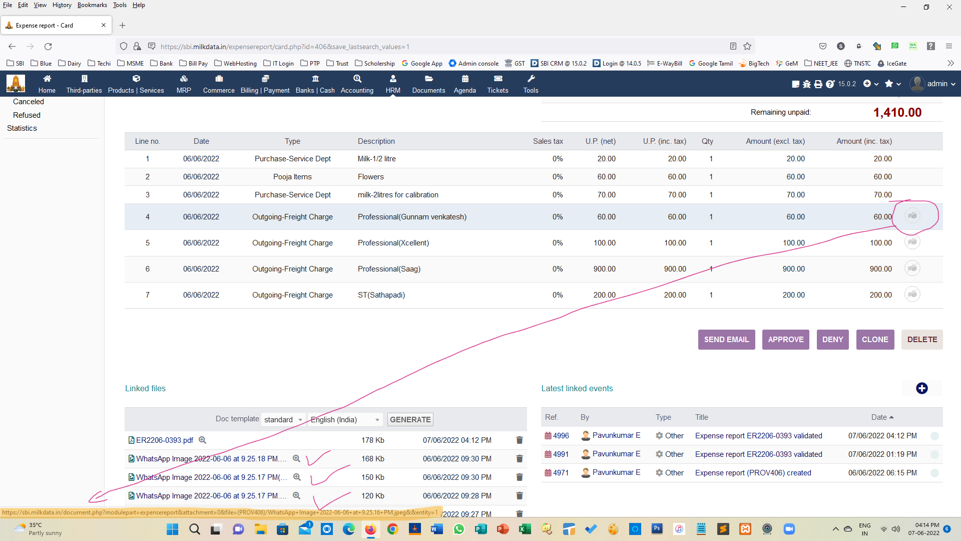

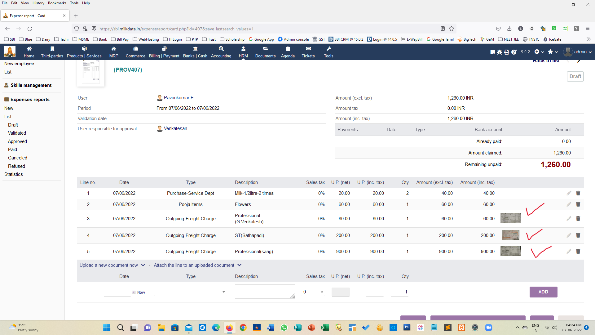

What I have experienced the thumbnail image is visible in Draft mode. (please see the attached image)
after validation the thumbnail image is not visible. It seems the thumbnail is pointing to wrong file location. (please see the attached image with file path).
Note: The same images are visible under the “Linked files”
kindly make the correction

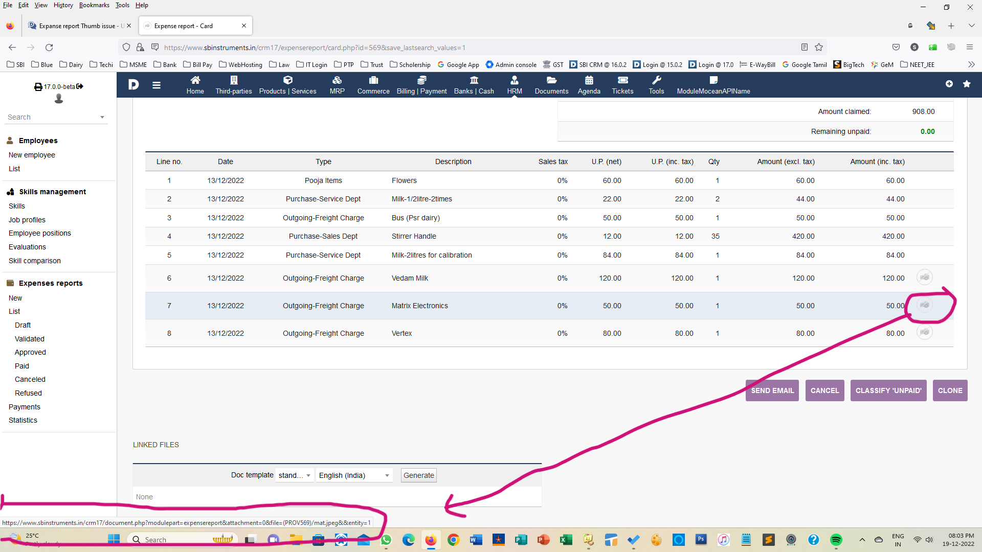

I am now in 16.0.2 (I am keeping a copy of lower version 15.0 in another hosting for testing purpose) this issue is continuing from 15.x.x and 16.x.x. Please see the attached screenshot taken from V16.0.2, It seems the Thumb image file path is wrong, so that we could not get to show the thumb image. even after validation of the expanse report the system assigns draft mode file path for the thumb image:
https://sbi.milkdata.in/document.php?modulepart=expensereport&attachment=0&file=(PROV532)/Benny.jpeg&&entity=1
please analyse this link (this is link of thumb image).
So after validation stage of the expanse report the correct link of uploaded image has to be fixed.

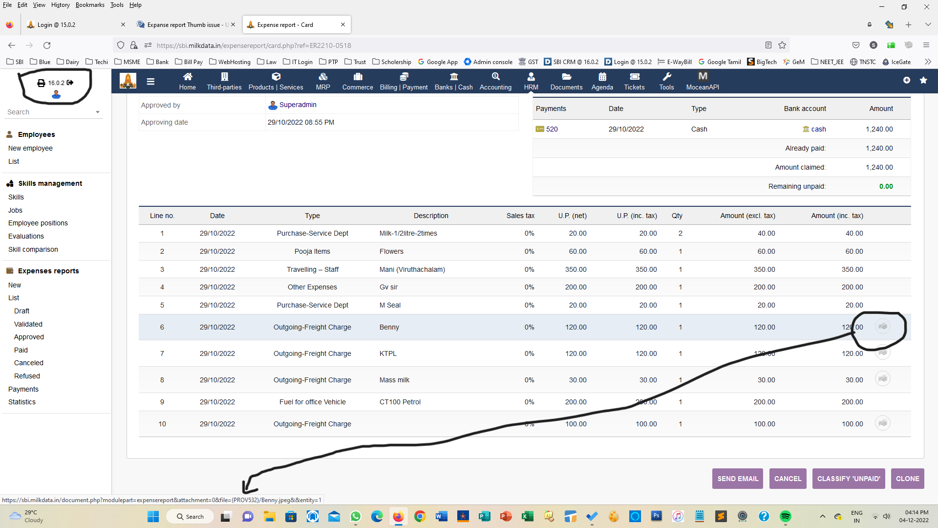

after validation of expanse report the file path become wrong path (for thumb image).
It should be like you wrote (documents/expensereport/REFofExpenseReport/thumbs/xxx_small.jpg)
But
when we move the cursor over the thumb the hyper link shows as follows
file=(PROV569)/XXX.jpg (please see the attached screenshot)

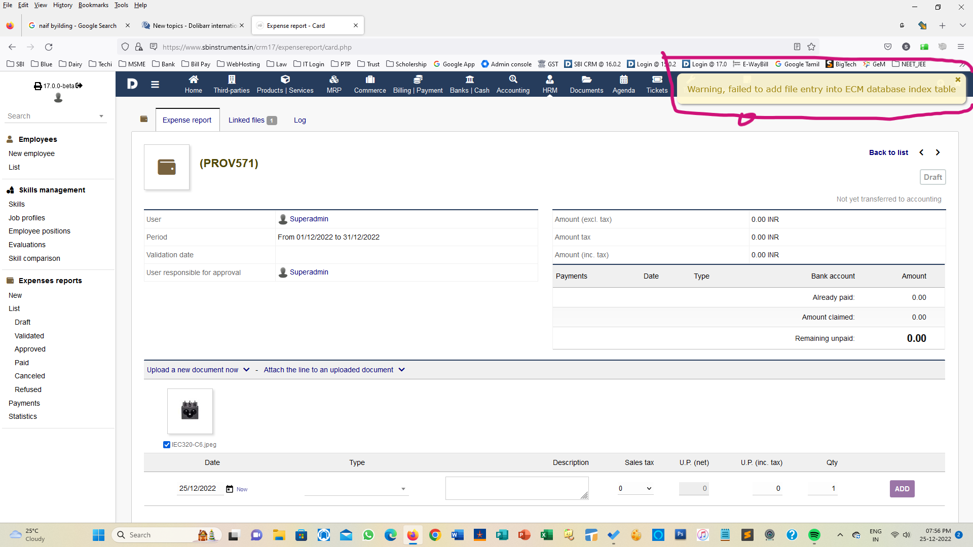

I observed the following warning (please refer the screenshot) while creating expanse report (V17-Beta-Test). at the time of scanned copy of bill (jpeg) uploaded. Is it related to this issue?
Further tested in both V16.0 and V17.0-beta, It seems the problem occurred at the time of Expanse report creation and the problem disappeared when we edit the validated Expanse report. (Back to Draft mode—>Edit & Save all the line—>Validate and submit for approval) all thumb image are now visible (like V14.0). I observed system works in Edit mode and not works in Create Mode.
Hope you understood, if you need more information like screenshot or screen record I am happy to provide. Thanks Merry Christmas
