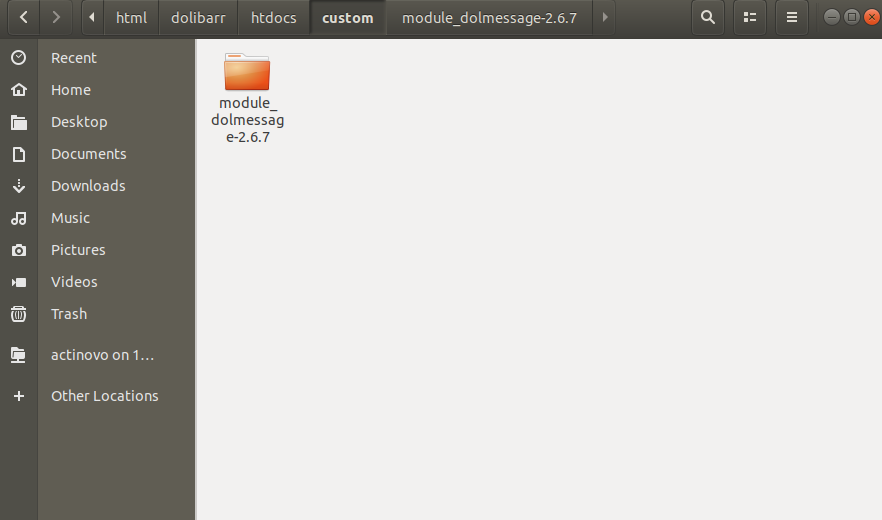

2- Make a printscreen of the custom directory

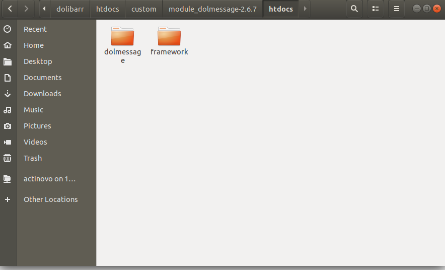

3- Make a printscreen of the module directory in custom

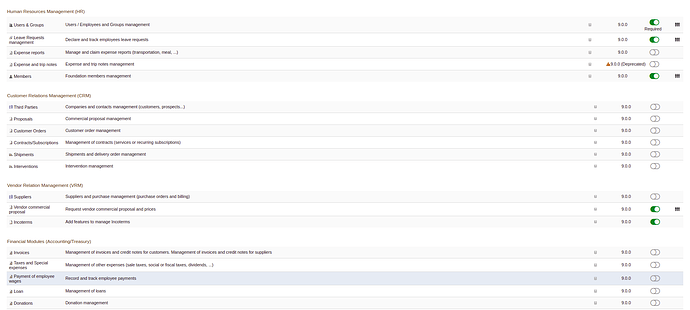

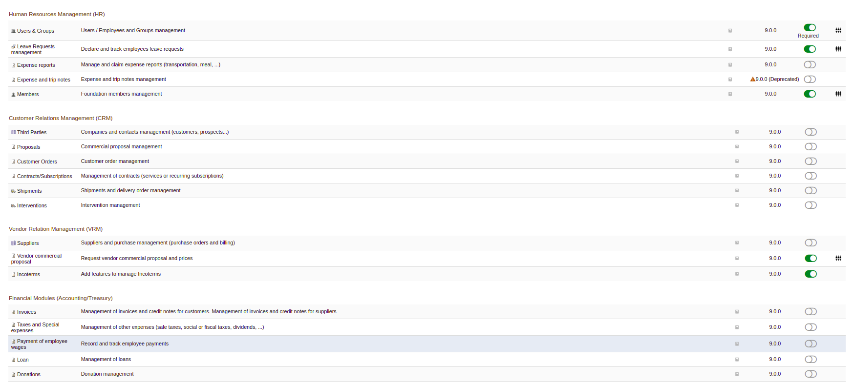

4- make a printscreen of the dolibarr screen of Configuration -> Modules
Module Name DolMessage
Ok this is normal, you have unzipped wrongly the module.
In custom directory, you should have the directory “dolmessage” not the “module_dolmessage-2.6.7”
You need to move the two directories dolmessage + framwork into the custom directory and delete the directory module_dolmessage-2.6.7
