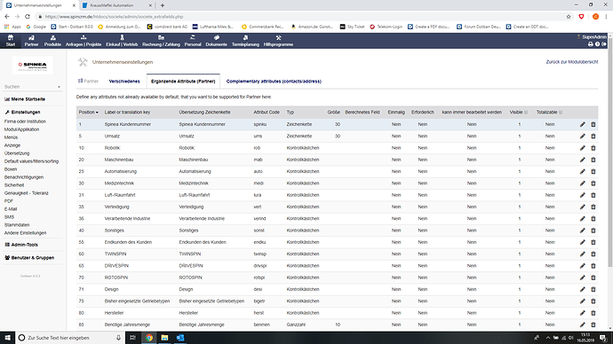

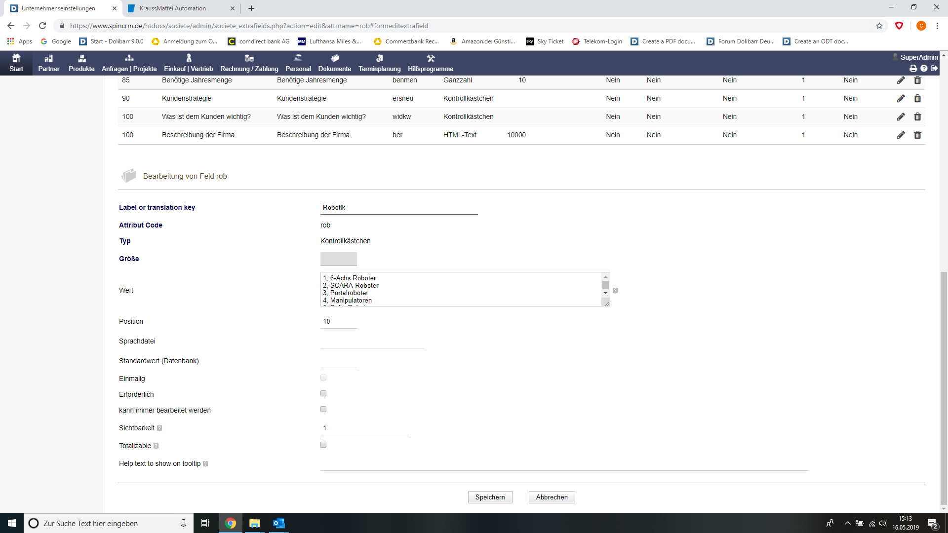

I want to create a report of my customers in the thirdparties ODT Template. I will give a overview about customer datas and needs (for that I created some extrafields), also about appointmens and projects with that contact. You can see the ODT in attachment.

The problem is, when I create the ODT with the ODT Modul, I only get results for the main tags, given by the systems. I don´t get results for the extrafields and even not for the projetcs and appointments, I only get the tags in the ODT. You can see the result in the pdf in attachment.
