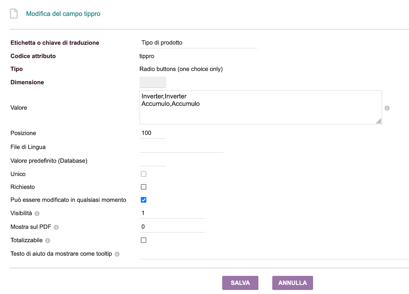

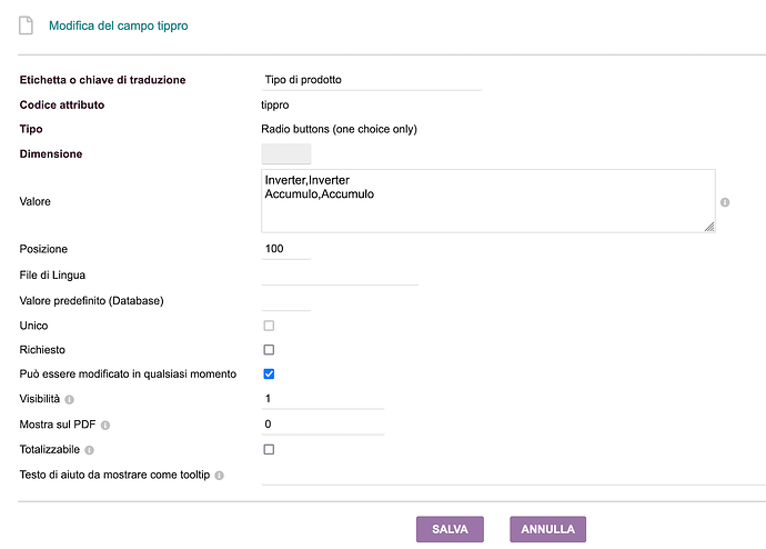

Can you print screen the “tippro” extrafield configuration ?
yes!. attached are the screens of the tippro fields

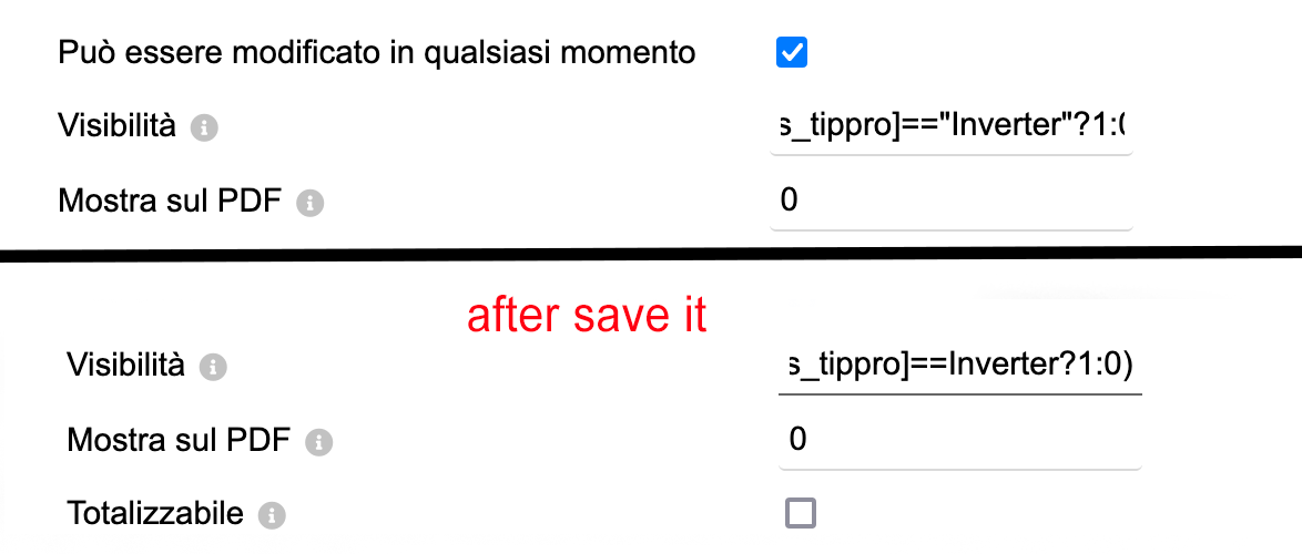

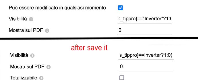

($object->array_options["options_tippro"]=="Inverter"?1:0)
I enter the string with double quotes. save it. When I reopen it the double quotes have been removed
