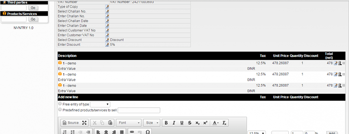

i cant understand what u say…
where in customer… ?
i create one custom filed in customer invoice like discount in pdf i get excat value but in facture.php file the total value cant change using customfiled… thats y i want other solution

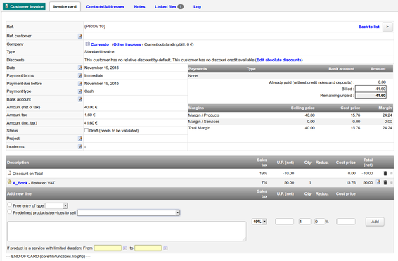

my installation is german but i made a screencopy
sorry, i dont know how to upload, i try again using atachment
if have any idea then help me… iwant to apply discount on total_ttc in invoice

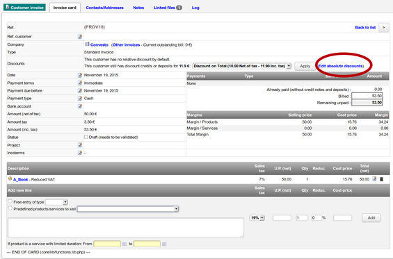

what i did is nut a total cache discount, i defined in the customer tab 2 that he gets alwys (far example) 10%, so every position is preselected with 10 %.
i search for your problem too. i want to give some % to end-sum, but this, i do’nt know how.

i explain what i do using custom filed…

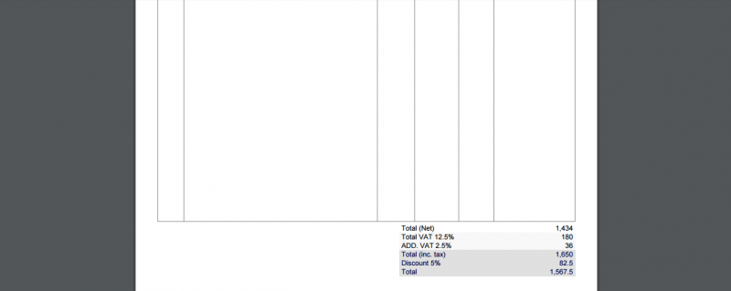

i create one custom file cf_entdiscount with text field in customer invoice…
in invoice i get discount using following code which i apply in pdf_crabe
price($object->total_ttc - (($object->total_ttc * (1 + $object->customfields->cf_entdiscount / 100)) - $object->total_ttc)
but i also change the global total ttc in invoice and billed amount…
please guide me where i m wrong…
