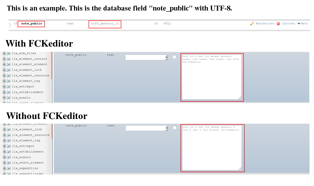

This saves German umlauts etc. wrong in the MySQL database.
Example: is from ö ä ü "& o u m l & a u m l & u u m l " etc.
I have tried in the database already the character set for the table with UTF-8 and latin_1. The result remains the same. If the FCKEditor is turned off, the characters are displayed correctly.

This is not what I mean. I have attached Schreenshots.
The problem occurs with all HTML fields. This makes a search in the database impossible. The FCKeditor I need however for the E-Mai dispatch.
