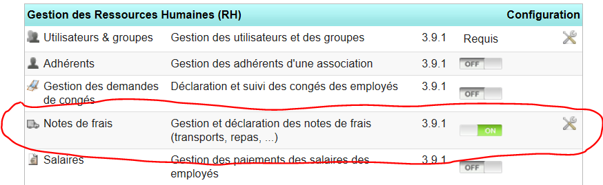

Is the deprecated expense notes module still enabled on your server.
Hi it was before the 3.9.1 update.
Now: see attachment.
Thanks to your help.

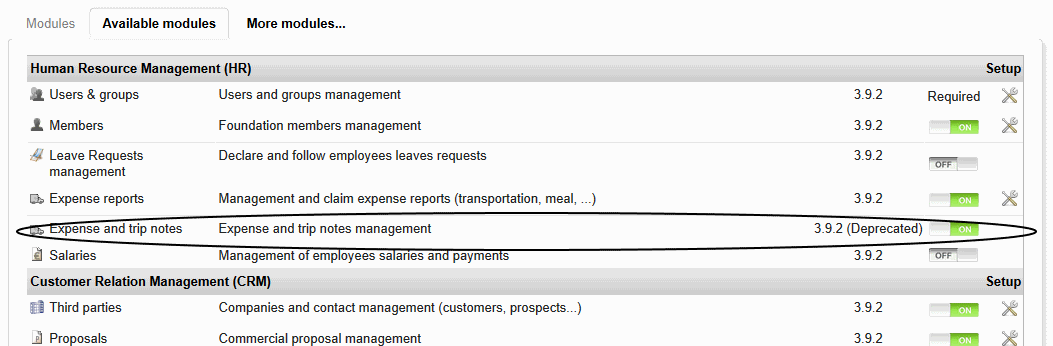

The solution is to follow the Eldy proposal
“Go into home - setup - miscellaneous.
You can set MAIN_LEVEL_FEATURES to -1 so abandonned module should be visible.”
Thank you Eldy.
Solved.
