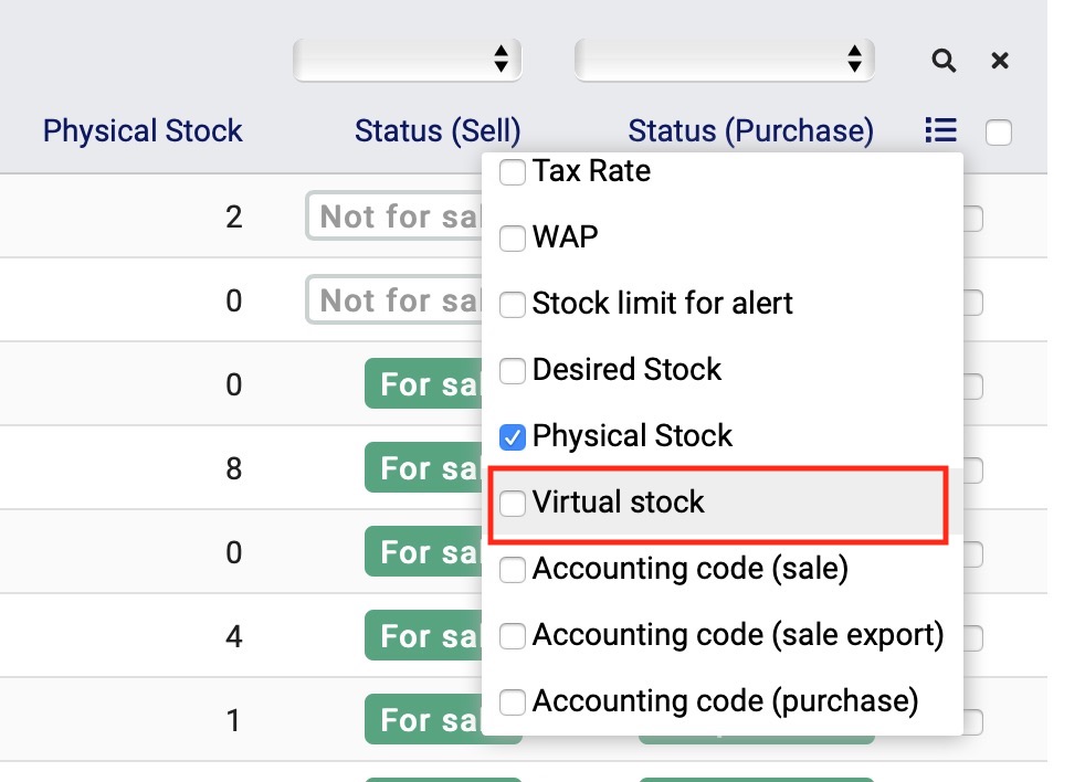

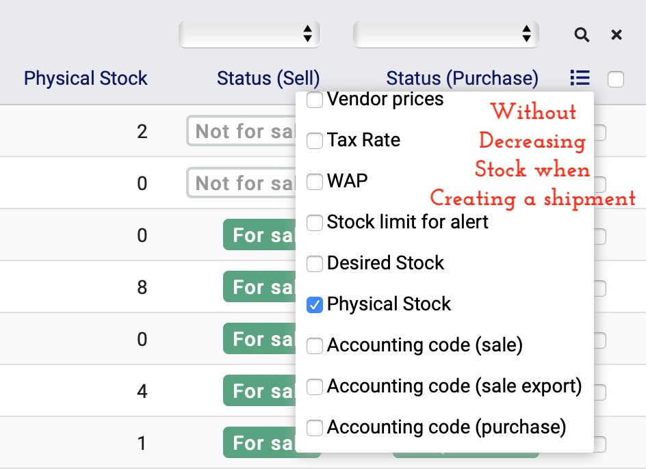

I am also posting another thread for being able to see virtual stock on products list page (This option somehow is related to the increase/decrease stock setup). If I enable the option to decrease stock when creating a shipment then I can see an option to add virtual stock on the products list page, or else I don’t see it there. Not sure why it is setup that way. But I am attaching screenshots for that here as well.

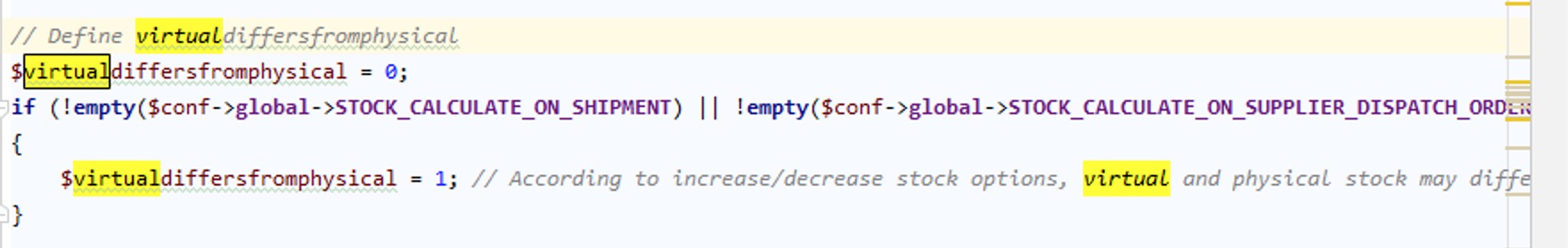

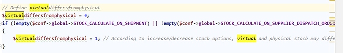

I actually resolved the virtual stock option just now.
While typing about it, I thought about it and tested a very very small change and boom it hit the right spot.
Just changing the following line on /product/list.php page (line 127 - version 11.04) works.
Change it to virtualdiffersfromphysical = ‘1’ before the IF Loops. That does the trick.
Using “or” is very strange. It means you will change stock twice. It seems for your case A that stock decrease in shipment is enough.
If you did not set stock decrease at shipment, it means the virtual stock will always be similar with real stock. So showing virtual stock is useless (according to code).
Do you have an example of what can make a virtual stock different than a real stock when stock decrease is not on shipment or reception ?

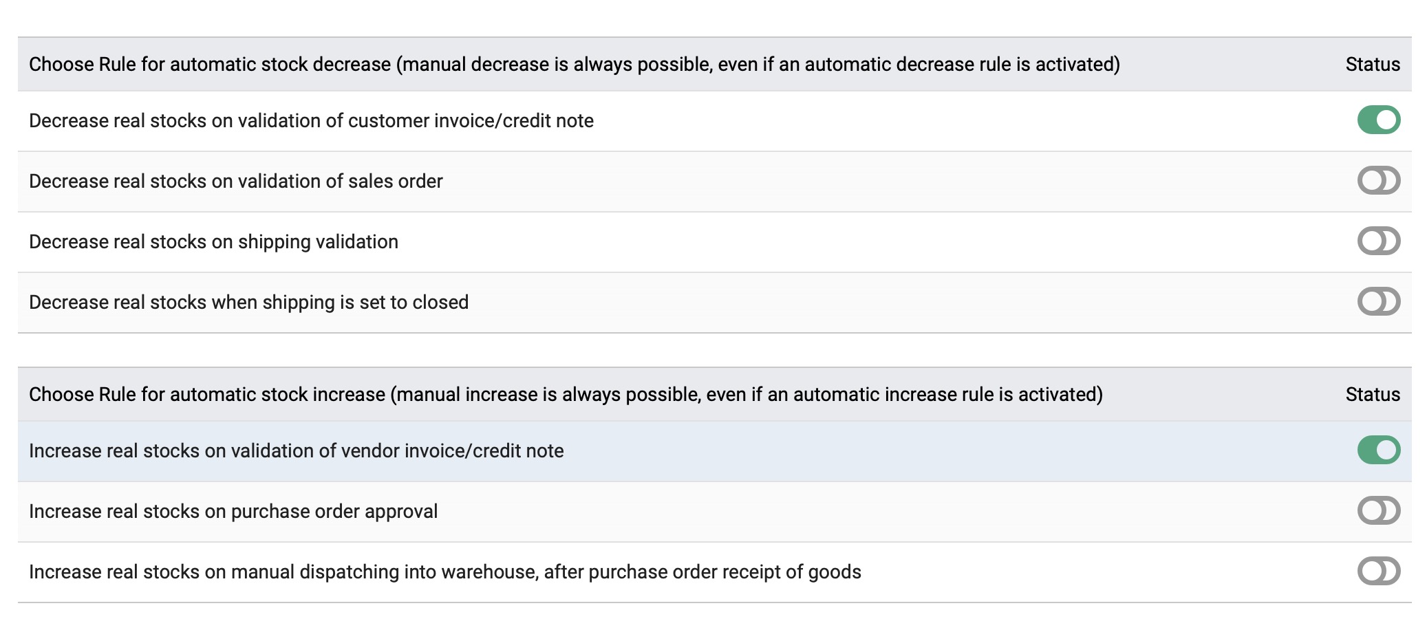

Now since the setup for stocks module is in such a way that we have a few options to decrease and increase stock as per the screenshot attached:
So for Case A, we need to reduce stock when creating a shipment because the physical stock actually reduces with the shipment.
And for Case B, we need to reduce stock when creating an invoice.
So our actual feature request is to allow reduction of stock when creating an invoice (unless for that sales order a shipment has been created - then in that case reduce stock during shipment and NOT again when creating an invoice).

Currently it is not possible to have a stock decrease rule that depends on the workflow that will be done later on order.
You must definitely choose between stock decrease on invoice validation (it means you don’t make shipment) or stock decrease on shipment (and only shipment will decrease your stock).

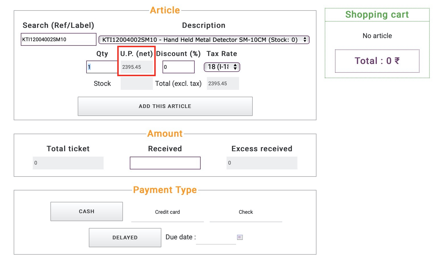

So now, my question is how to edit prices on POS page itself?
Sometimes our prices vary and they might not be adjustable with the default pricing. (We are trying to get more organized in this sector but in the meanwhile, is there a way to edit the prices directly on the POS Page? I have highlighted the same on the screenshot. It is greyed out and is un-editable unfortunately.
The SimplePOS module will probably abandonned because the TakePOS module available in v10, v11 an v12 is better now. A’nd with TakePOS, you should be able to edit price

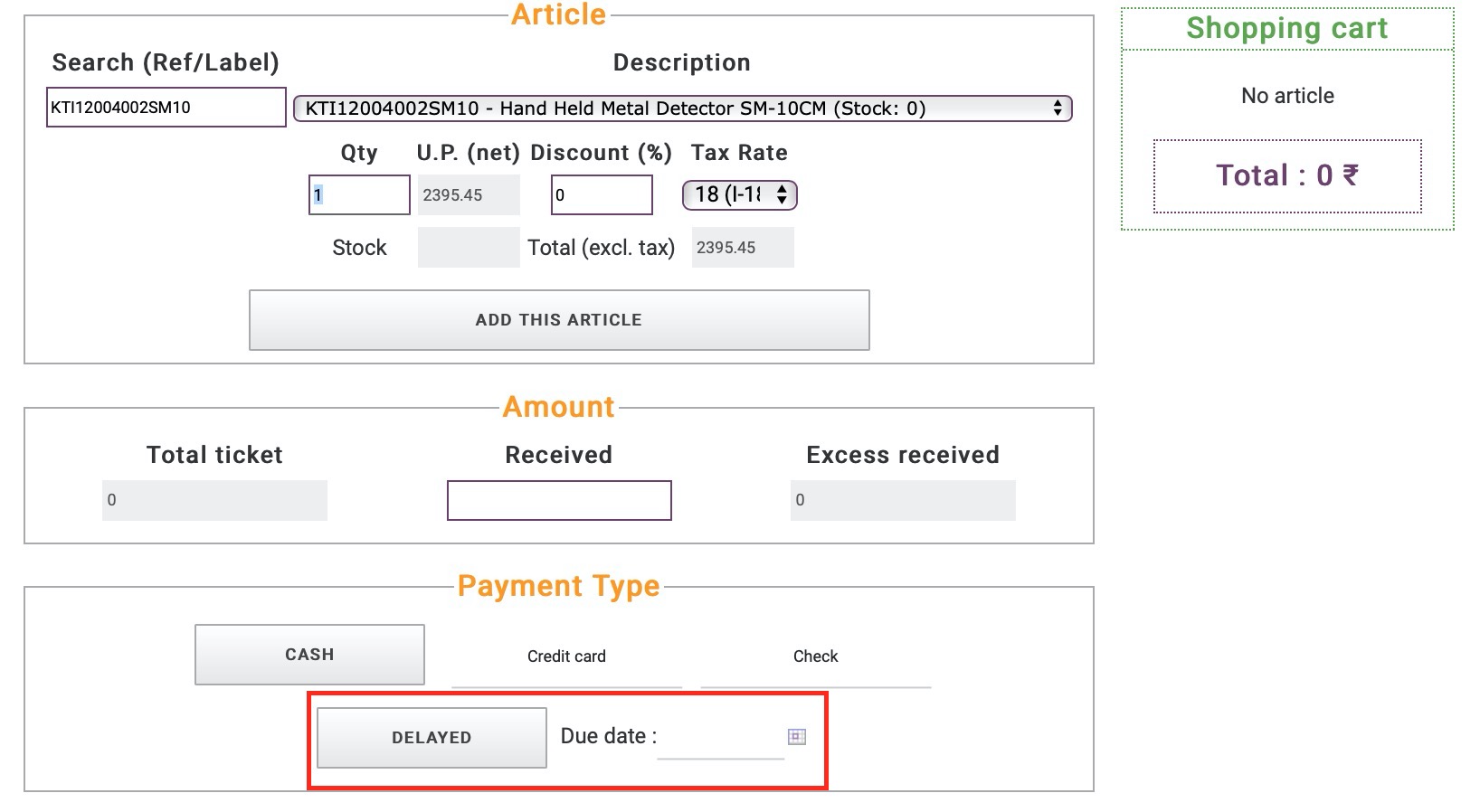

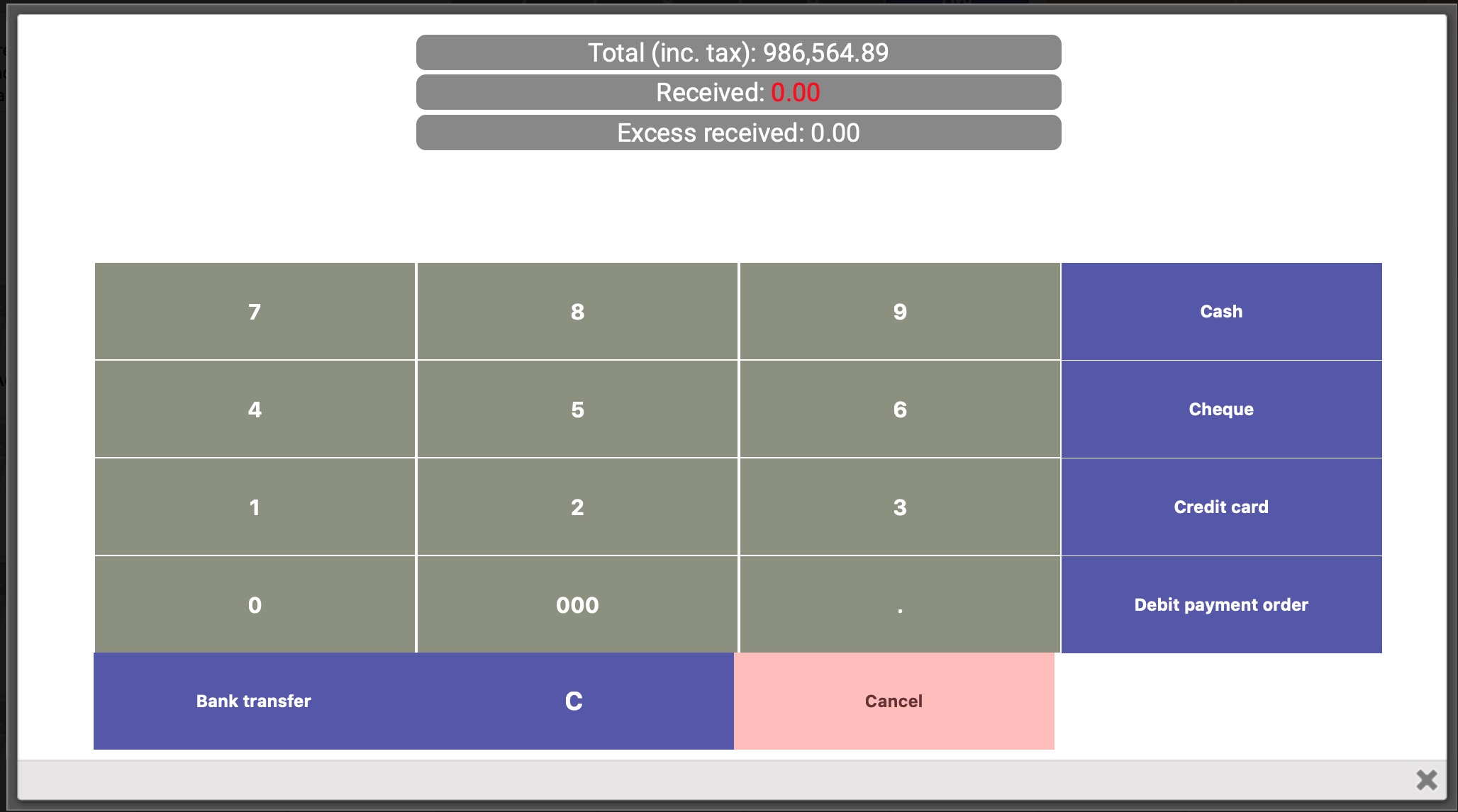

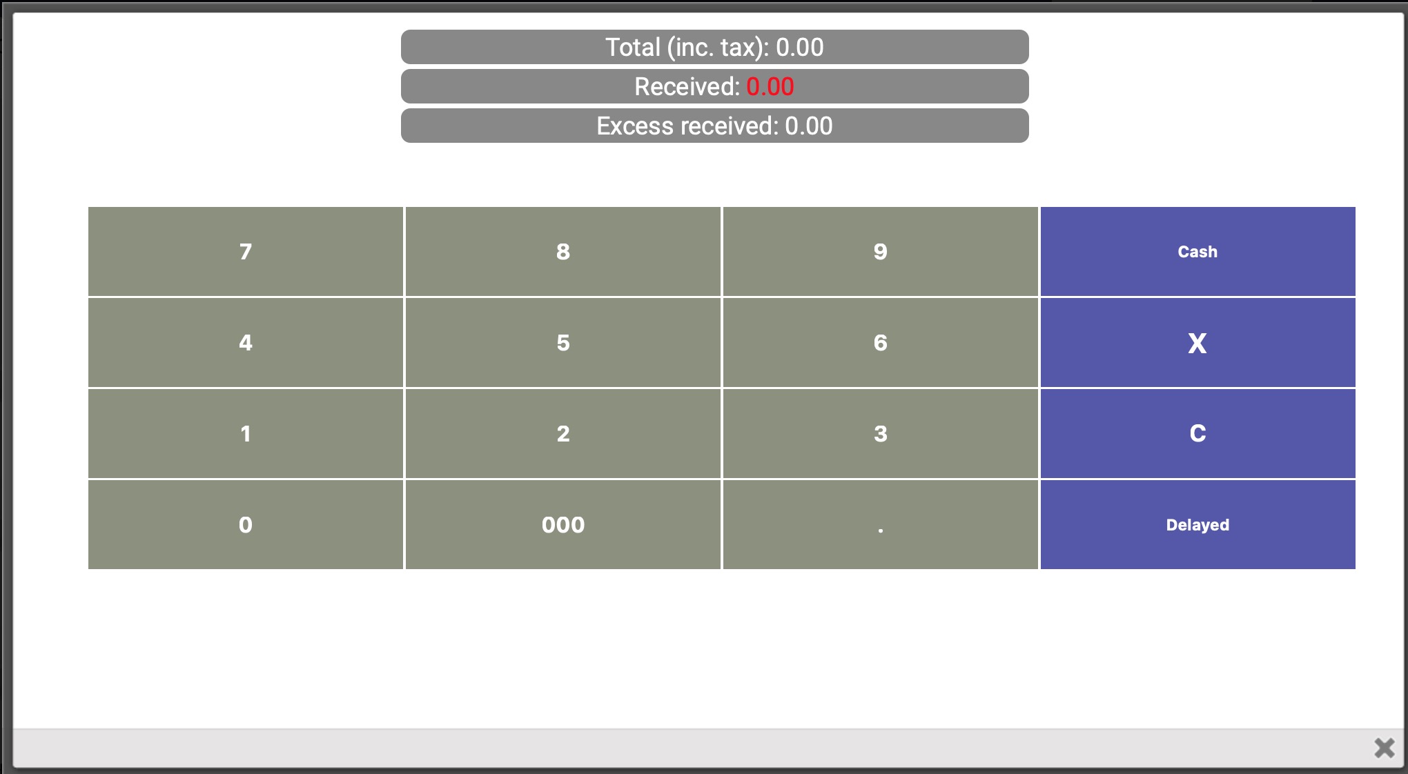

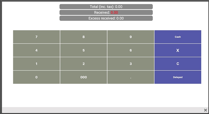

The only problem I am trying to figure out right now is how to add a delayed payment option. If the payment would be received on a later date, how can we add a delayed payment due date while using the TakePOS module?
Screen Shot for payment options in TakePOS & SimplePOS attached.
I tried finding a few answers on google & forums but did not find any options there either.
Any help would be appreciated.

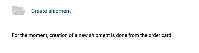

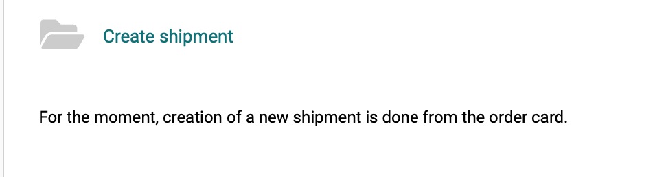

I just realized, we could just create shipments directly for the all the orders and not worry about the POS at all.
Can you please guide me how to make a shipment directly without creating an order?
Screenshot attached for the error when we try to create shipments directly.
If payment is delayed, it means it is not paid. The goal of a POS is to record payment. If payment is delayed, you don’t need a POS system. Creating an invoice in the backoffice may be enough.

With TakePOS, you should be able to make delayed payment. Did you try with 12.0.2 ?
Dear @eldy,
Thank you for the update.
I actually reached out to Andreu (from the TakePOS Team) directly through their website - http://www.takepos.com a few days ago.

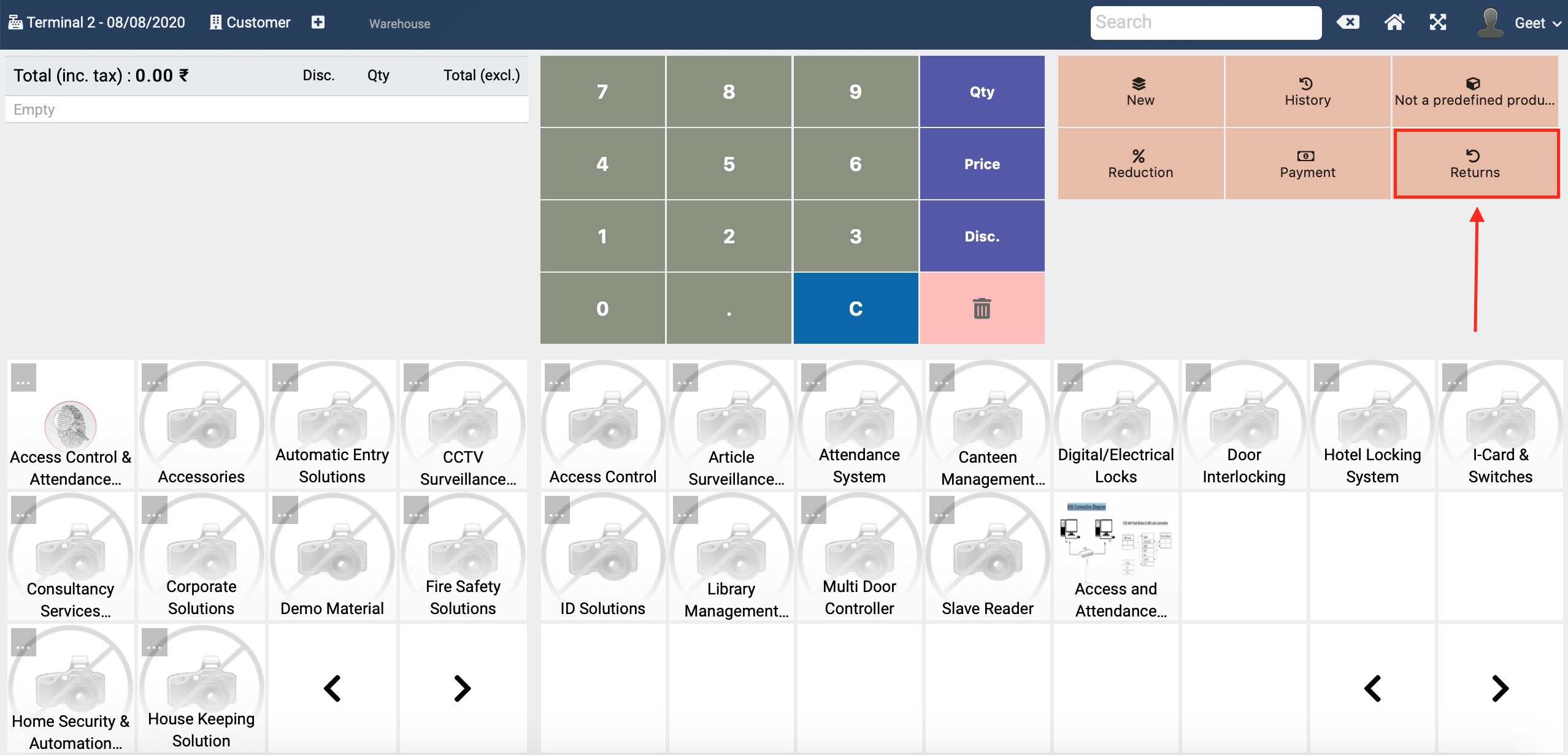

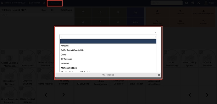

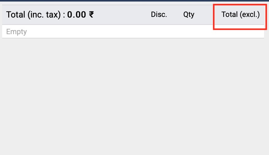

We asked them for 3 customizations (Customizations for each of them are attached).
  1. They helped us with this delayed payment option customization. I am not sure how it is in the V12.0.2

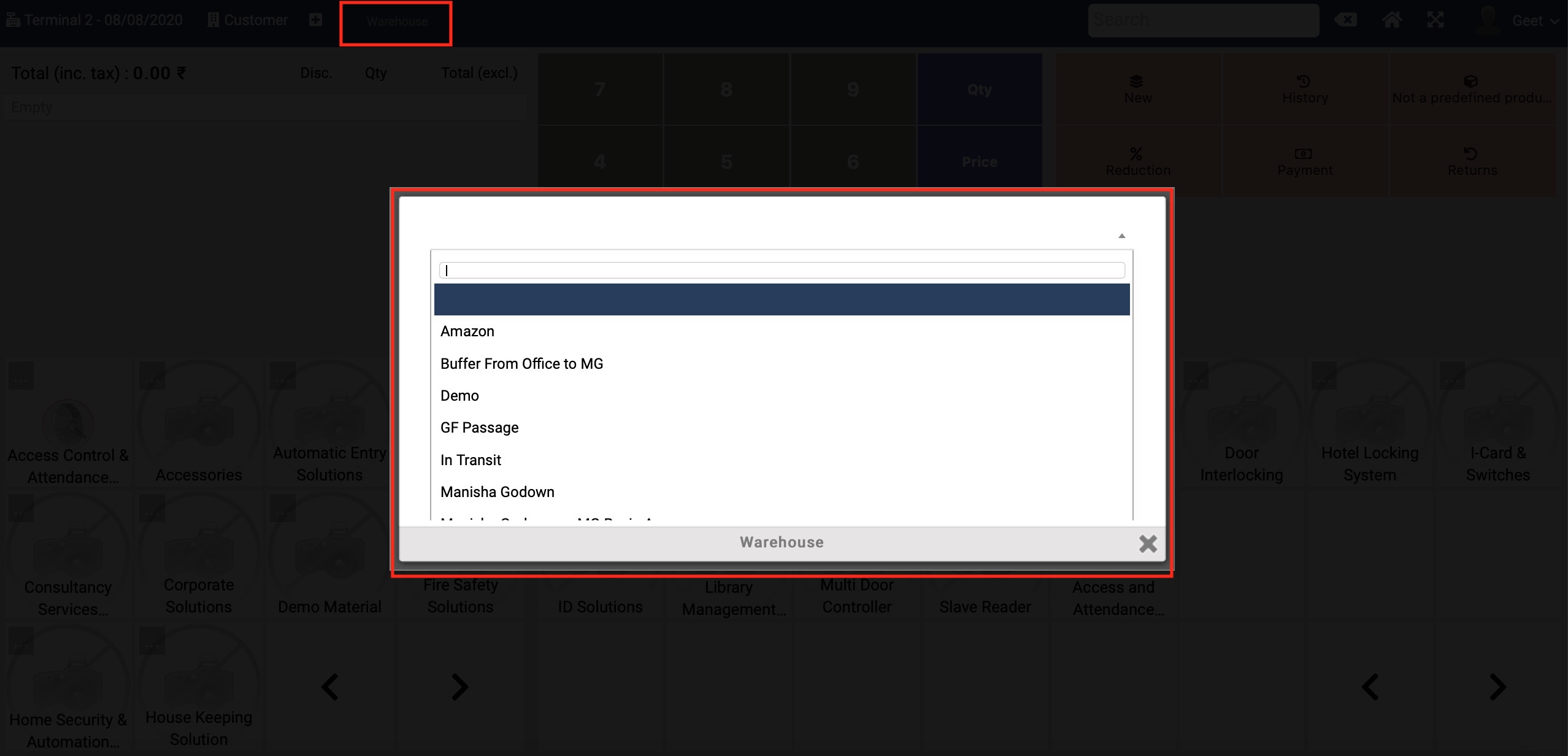

  2. We also customized our TakePOS to be able to change warehouse from the POS Module itself (to reduce stock from different warehouses based on the product - but only one warehouse can be selected in one invoice as per dolibarr workflow).
  3. We also now see exclusive tax amounts for products and edit those directly from POS. Also an extra POS Returns module was added.
