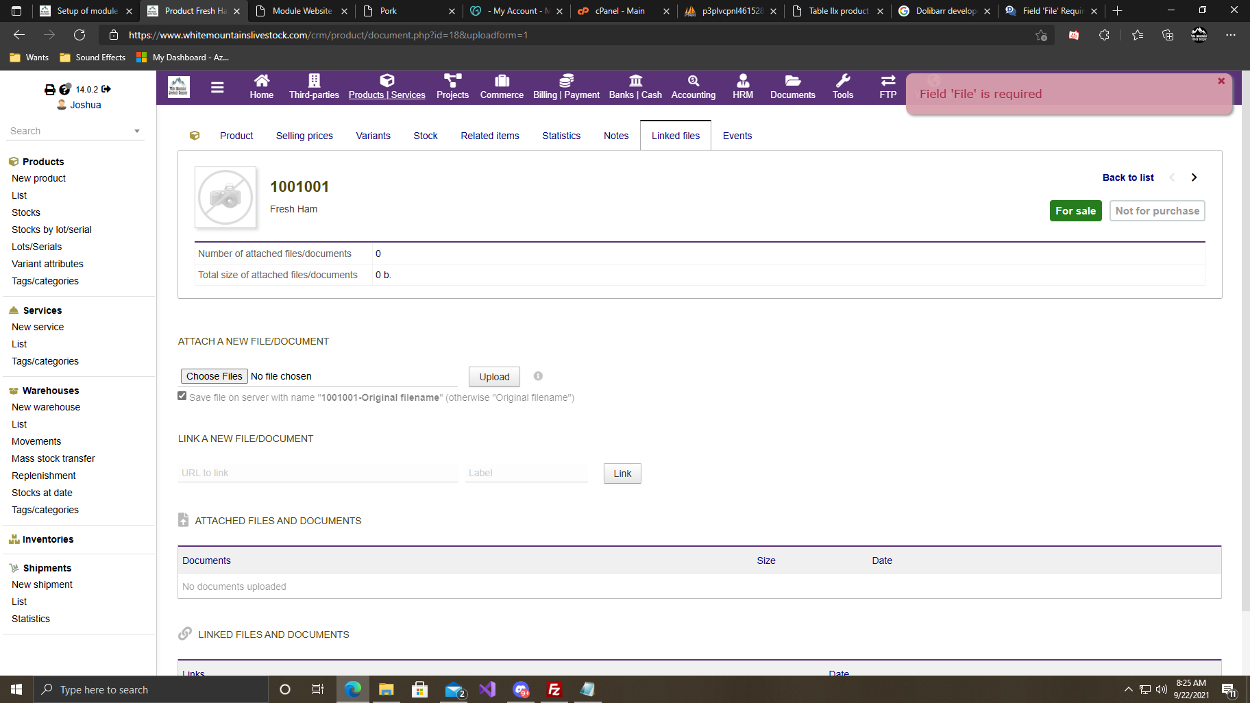

Field 'File' Required when uploading file anywhere in dolibarr
Whenever I try and upload an image or document anywhere in dolibarr i get the error "Field ‘File’ is Required. I’ve been trying to figure it out for a few days but so far no luck. Hopefully someone here can help.

Can you give a print screen ?
Dolibarr logs ?
I’m using version 14.0.2 and it’s installed via installatron from my hosting provider. It was installed to a /crm/ directory under my primary domain. Everything else seems to be working but the file upload is having issues.
