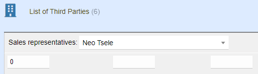

Good day
Please will you add a 0 in the filter. I found it works for me and the results show up.
