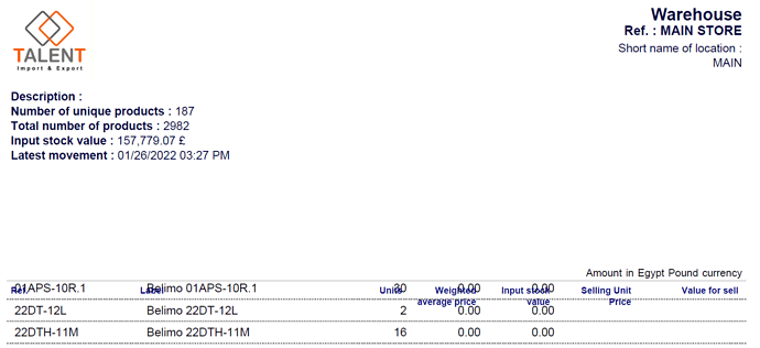

could someone help me to fix standard pdf format for warehouse (as the table data overwrite the table header) as per attached screenshot

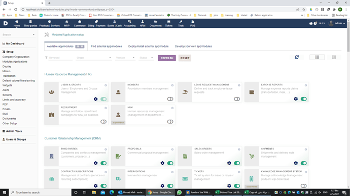

I’m using ver 14.05
I didn’t make any changes at all
I don’t have any external modules

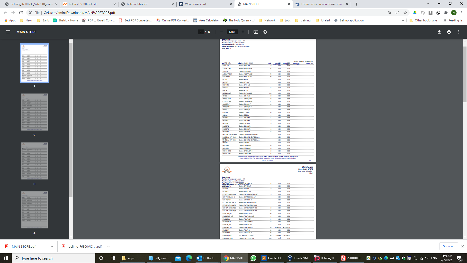

I notice that my format issue appears only if I have 30 rows or more in stock, if items less than that pdf is ok
i need help to reduce number of rows per page to 25 row maximum
Is your original screenshot from the first page of the PDF?
Yes, this is from first page

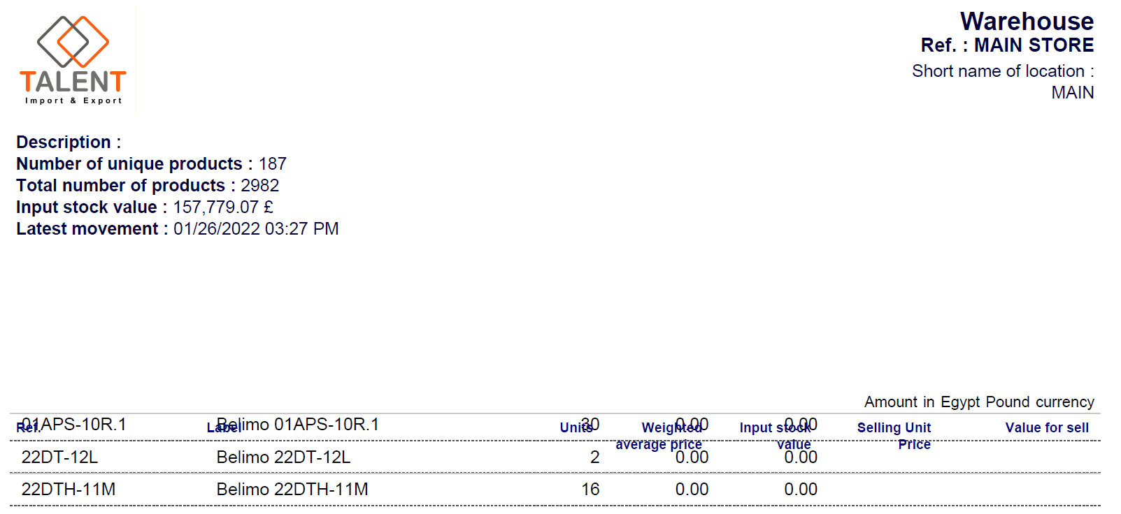

please find screanshoot after editing php file as per your request
I would like to help and assist with the development of Dolibarr, but I don’t know much PHP, and from looking at the code, it looks too complicated for me. I’m struggling to understand it! I don’t know the cause of the problem after looking at the debug value in the screenshot. I can confirm that I also get visual problems with overlapping elements when the generated PDF becomes more than one page, but mine are on the second page.
