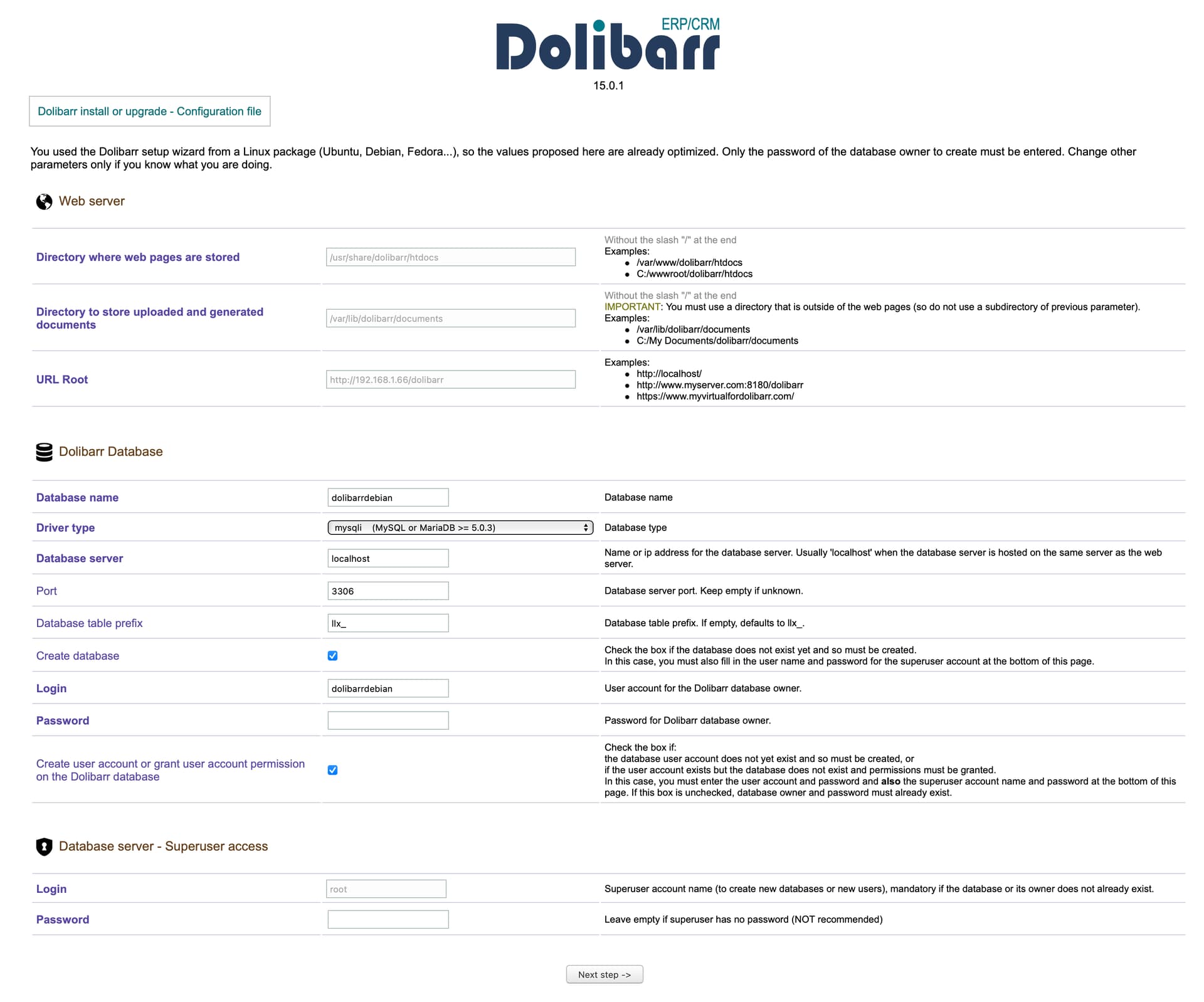

Ok. I have got to the webpage for Dolibarr, so is a good sign.
It does say that mysql is not loaded.
checked in cli with command
sudo service mysql start
It states failed to start. no mysql service found.
ok. looks like the user accounts are not working as the install has maybe created users/passwords etc, which its asking me for, and I don’t have.
I see this is a problem that has been around a while.
Am I easier to just re-install mariadb than try to change or find users passwords etc.
Is there a default password
Got it working.
The installer by all accounts doesn’t look like its installing MariaDB. (I’m utterly new to linux, so maybe it is, I just can’t find it.
I tried this on two different VM’s one running Ubuntu, one running Bullseye, and same results.

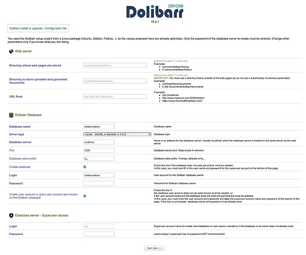

Ok, I got to the final page on loading everything up, and still only access to dolibarr was up the install page and no further.
I loaded a fresh copy of MariaDB, with passwords I then new, and access then granted through to the company setup page.
