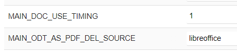

I tried this but did not work
what will i be missing
i gave 1
MAIN_DOC_USE_TIMING ► Add a timestamp at end of generated document. Value must be format of timestamp. For example: %Y%m%d%H%M (only for ODT files)
i see this only works for ODT files
any work around for pdf file
