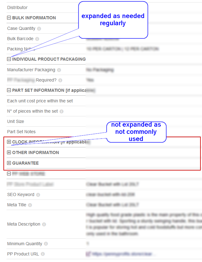

This is for my products page in view mode. its the same for edit mode. all these lines/fields are dolibarr product extrafields.
As extrafields are part of the core, in the third parties module, the same should apply.

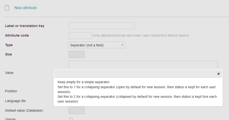

This is the same setting from third parties module in v14.0.2
I found it by accident but it is mentioned in one of the recent changelogs I think.
