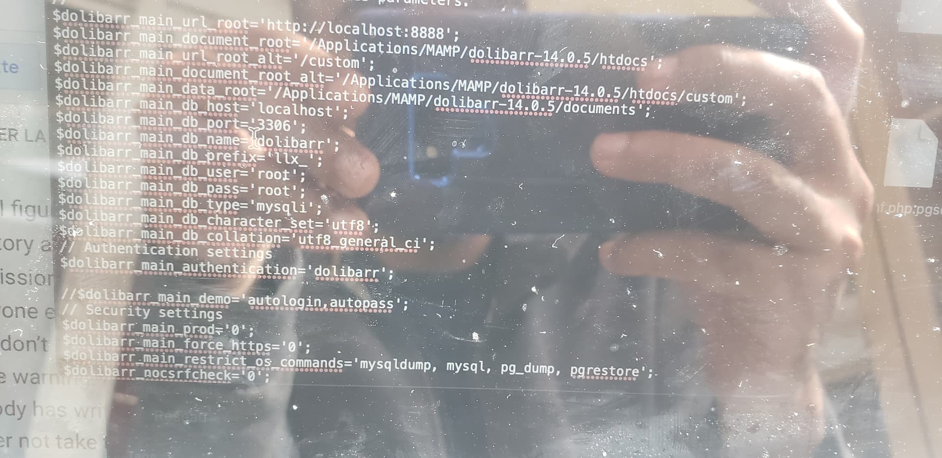

Hello after all instal i have one message for security but i can resolve it
i don’t know where I need to change here ?
