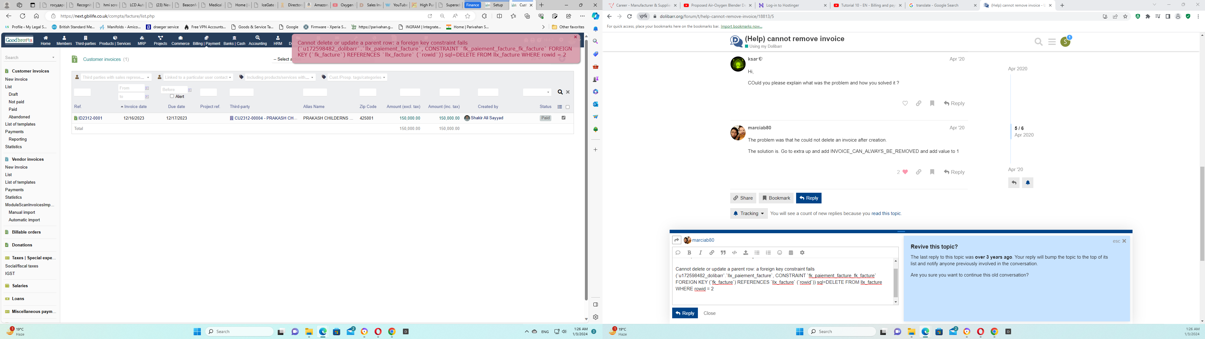

thank kyu so much. But while deleting there is an error.
Cannot delete or update a parent row: a foreign key constraint fails (u172598482_dolibarr.llx_paiement_facture, CONSTRAINT fk_paiement_facture_fk_facture FOREIGN KEY (fk_facture) REFERENCES llx_facture (rowid)) sql=DELETE FROM llx_facture WHERE rowid = 2
This is so useful
Thank you @marciab80.
@ssahil.5029 This is probably due to the fact that you try to remove invoices that contain payments to them. Try to delete the payments one by one and then try to remove the invoice again.
