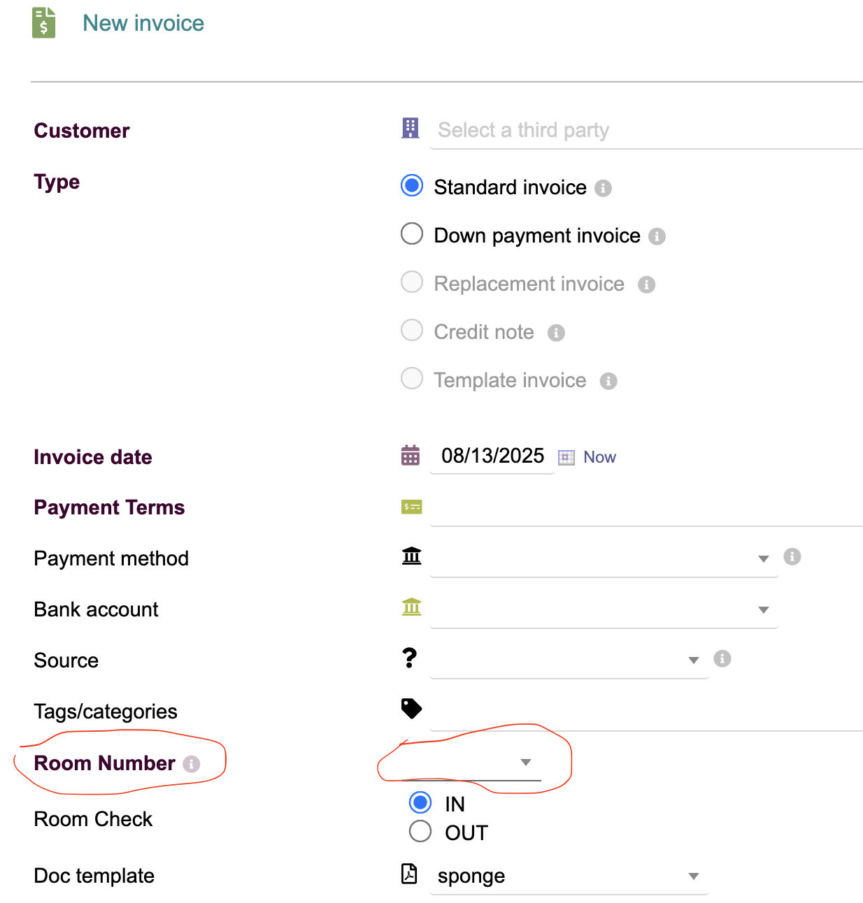

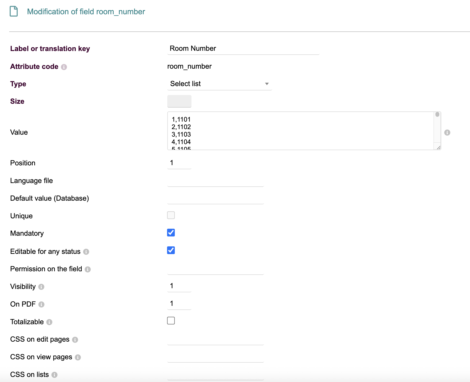

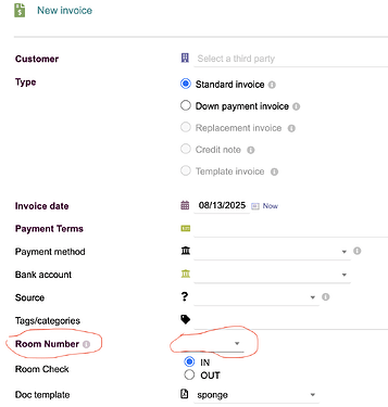

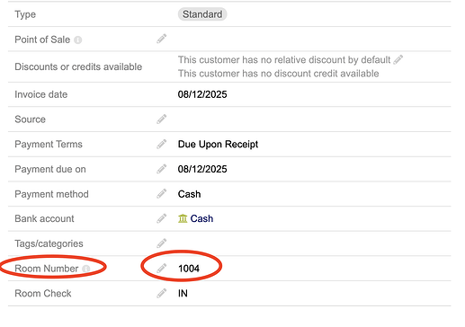

I went into Setup > Modules > Invoices > Complementary Attributes (invoices)> Custom, created a custom field displayed in the New Invoice portion (Attribute code “room_number”):

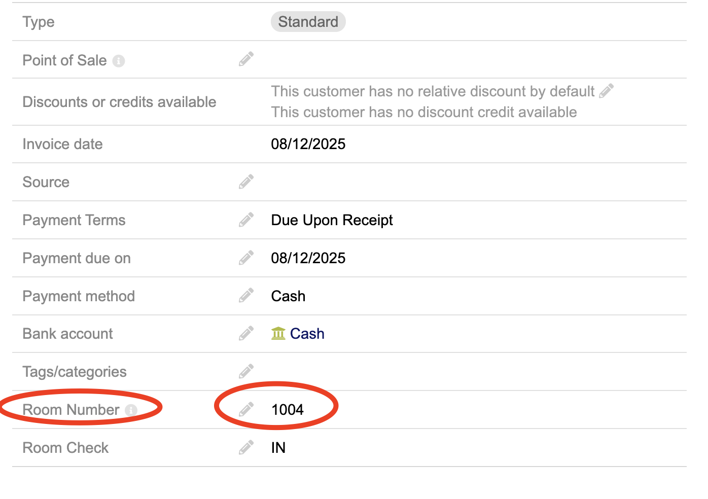

Basically I need to enter a Room Number, which is easily changed at any point of the invoice life cycle (Draft, Valid, Paid), which I achieved successfully:

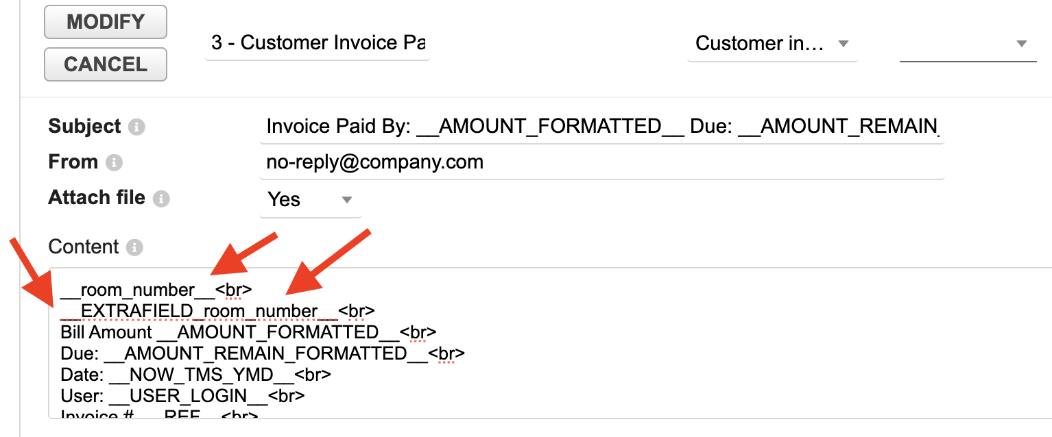

When an invoice is validated, an e-mail notification goes out to an address, which is properly setup and works fine. My question is: I don’t see the “room_number” attribute showing up in the Avaliable Substitution Variables. It doesn’t show up in the e-mail notifications sent. The other variables are being pulled from the invoice, working as intended.
I tried doing this using ExtraField as shown below. What am I doing wrong? What is the correct method? Is what I want even possible this way in a simple way?

Hi @shadysundays
Try in all caps
__EXTRAFIELD_ROOM_NUMBER__
Yes! This worked perfectly! Thank you so much! :clap: :smiling_face_with_tear:
