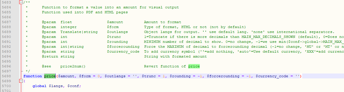

in the file core/lib/functions.lib.php, you must adapt the function named price
and at this line, you can change the output string to get the indian numbering

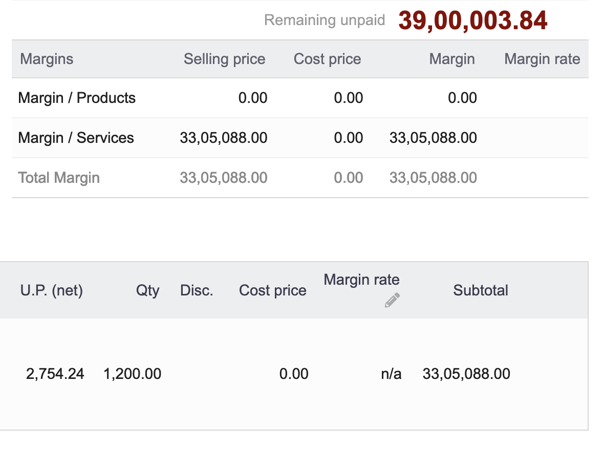

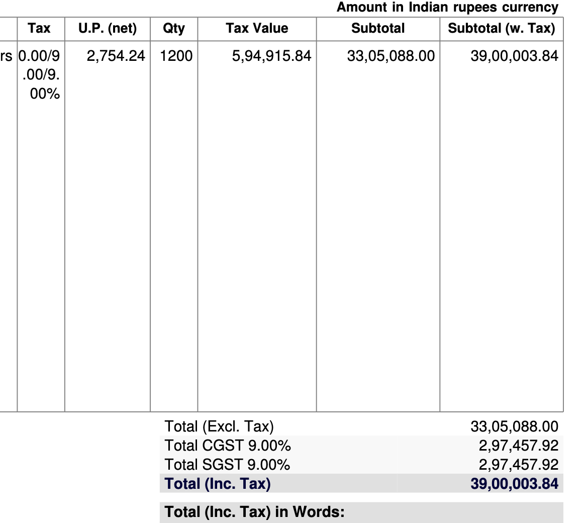

here is how it would look on the card view
and PDF

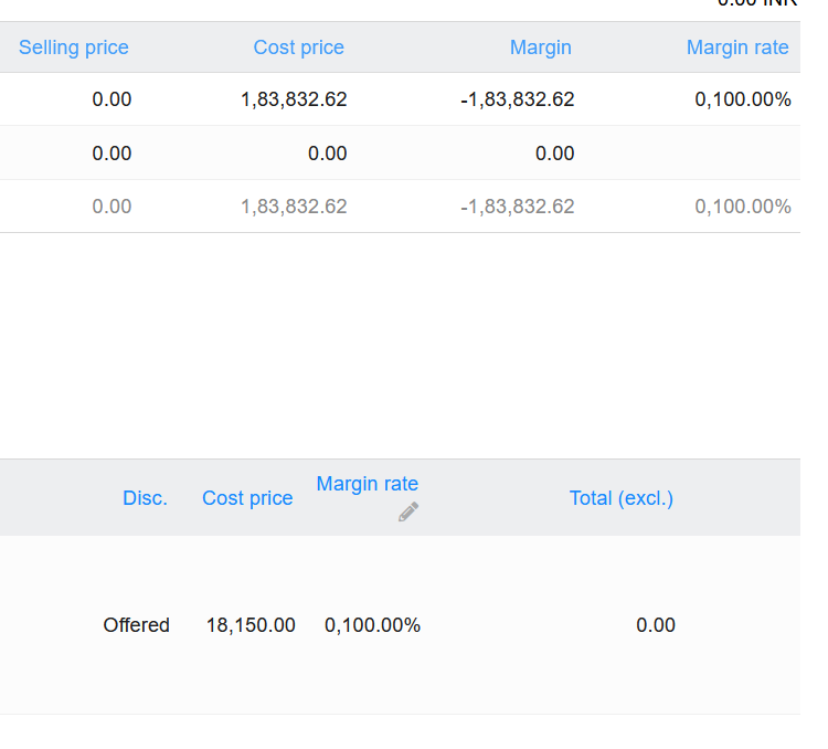

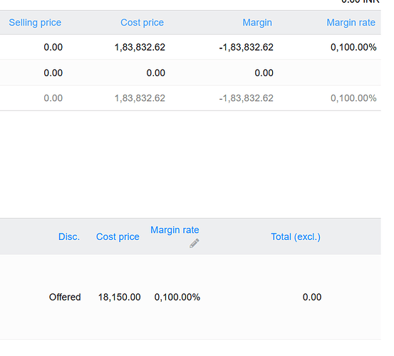

I’m getting issues as an output in PDF and Card formats for the following attributes:
All this happens when I use money_format function to have an Indian Currency Format.

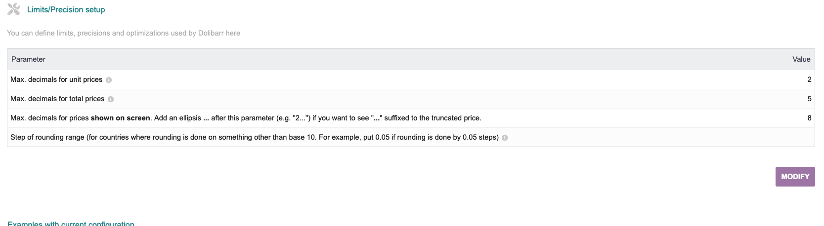

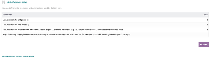

Check also the home - setup - accuracy.
What do you lean with using money_format ?Such a function should never be used in code. There is no such use in official version. You already have mehods likes price(), price2num()
I have set the correct country in Home - Setup and Home - Display i.e. English (India) (en_IN)
In Home - Setup - Accuracy: I have default setting as mentioned below

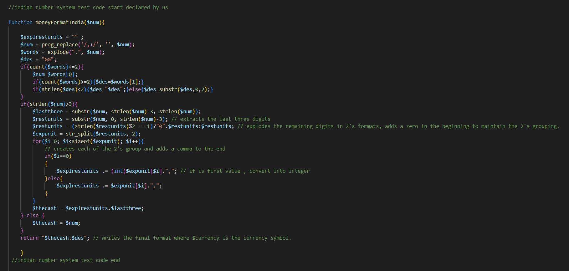

i tried to to modify core>lib>functions.lib.php
as per @pcbleu
here is output
but there is slight issue
hope this helps and let me know if you got any suggestion in code to improve this (hope this get implemented in next version of official version for indian users)

What is the issue in your logic? is it about the Margin rate or Total (excl.)?
If you can share the code here, it will be easier to identify and address the problem.
