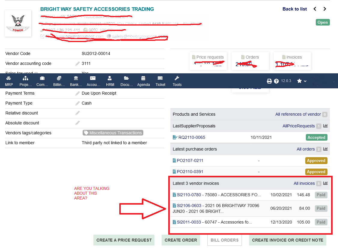

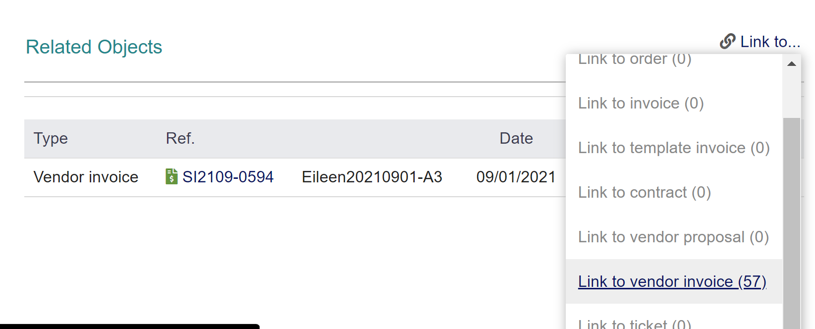

Open any “Purchase order” card, and at the bottom, you have “Related Objects”. Click on the “Link to” on the right side, choose “Link to Vewndot invoice”, and you will get the list of vendor invoices with a radio button in front. Mark the proper invoice and click the “LINK” button at the bottom.
Same applies for the “Vendor invoice” card.
