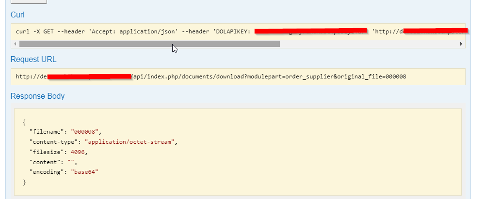

I do have an external app to Dolibarr that requires to download a document and do something with the document. However, I am struggling to understand, how does one get the actual link to the PDF via REST API. Below is the response I am getting. Could please anyone help.

Old topic but the answer is to pass a correct filepath, not only the name.
On the example given above, instead of &orginial_file=000008 at the en of the URL, it should be &orginial_file=000008/000008.pdf
Use the token from /login in the DOLAPIKEY header when calling /documents/download to access the PDF without logging in.
