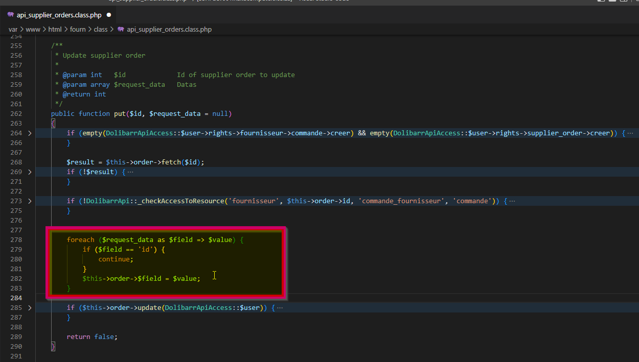

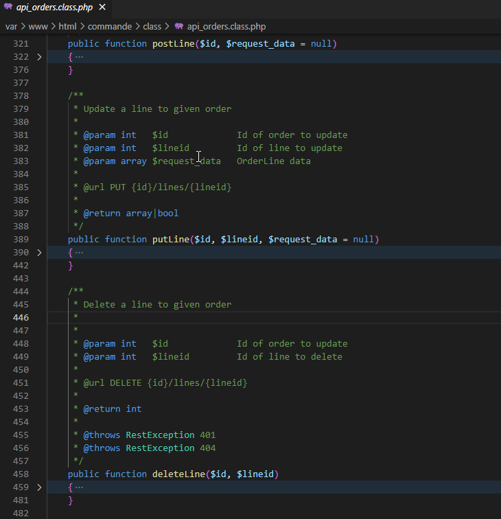

We are trying to understand how to update lines of a Supplier Order (supplierorder) using the REST API.
No error message is returned. The endpoint returns a 200 OK status message, but the supplierorder is not being updated. Is this a bug or we are doing something not correct?
Below is the request payload to update the order line on the endpoint http://dev001.xxxx.xxx/api/index.php/supplierorders/58

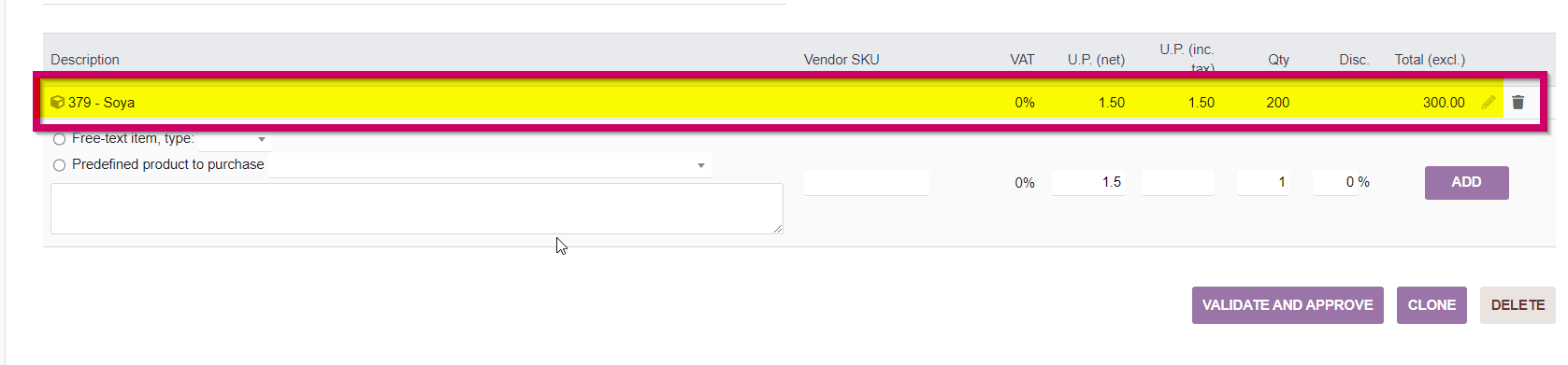

Attached is the line that would would like to update.
