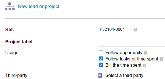

First you need to set average hourly rate for each people .
Then when you want to calculate labour cost you will need to create a project ( you will need to enable the project module ) or create a PO (or others ) with project to track the time and bill .
