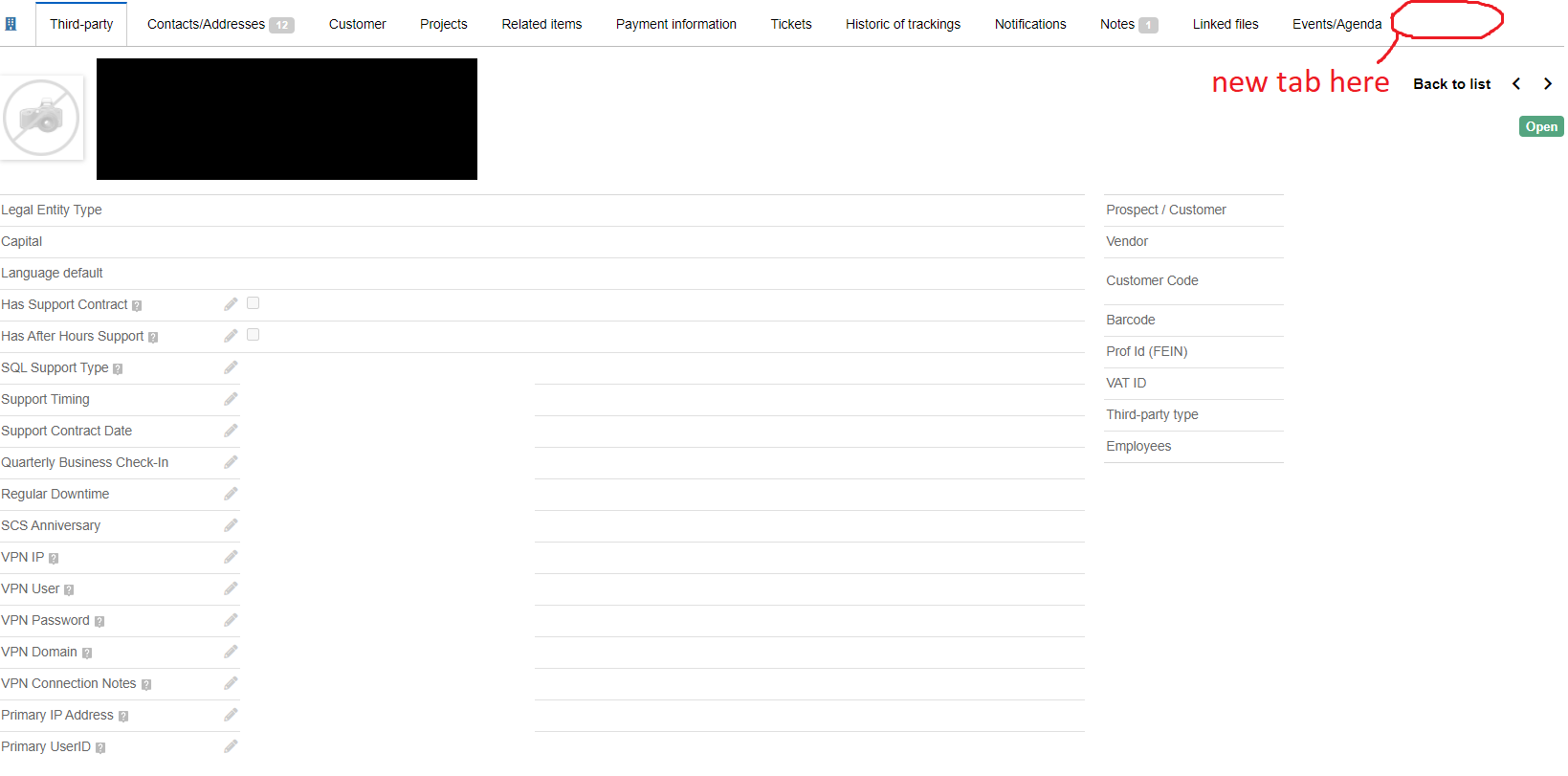

I would like to add another tab to the third party to store some extra fields. I’ve looked through the wiki on the tabs system but cant seem to find the right descriptor file to add another tab. I am currently using 12.0.0 version of dolibarr. Thanks in advance!

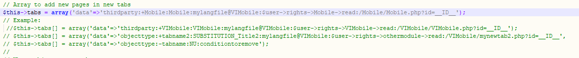

I’ve created a new module and followed the steps in the following link. Even though I believe I followed the steps correctly, the new tab is still not visible. Is the wiki outdated or missing a step, or is the error in my code?
https://wiki.dolibarr.org/index.php?title=Tabs_system

Are you sure the condition that is set ‘$user->rights->Mobile->read’ is true? Otherwise the tab will not appear. Try replacing that piece of code with ‘1’, and look if the tab appears, also when making changes reinitialize your module.
Also I would recommend taking a look at this documentation page:
Here, under the ’ To add your own tab’ title, the format of that string is explained.
