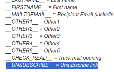

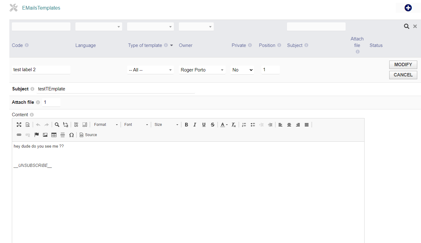

Hi
Just type that ( left hand site of " = " ) in your email , and it will show a unsubscribe link to your customer .

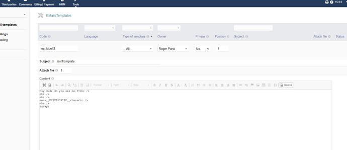

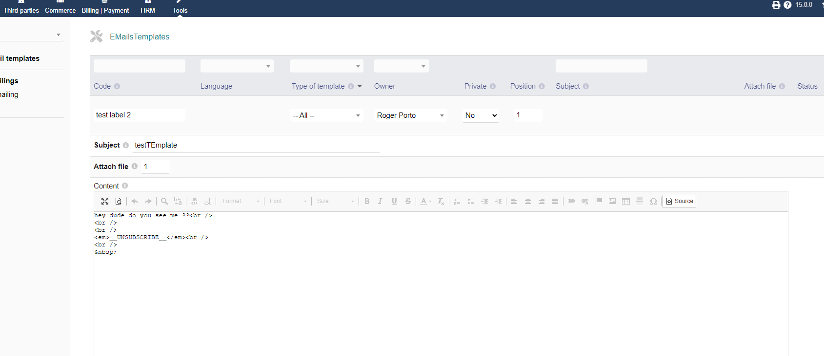

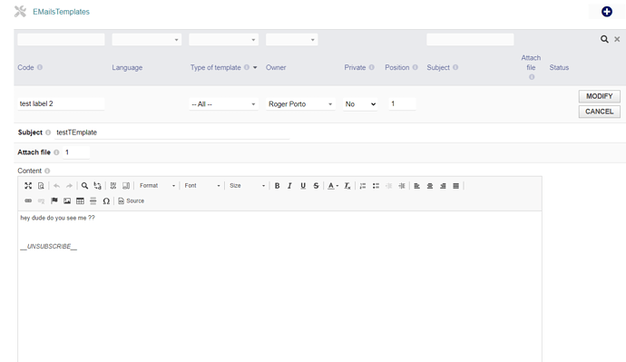

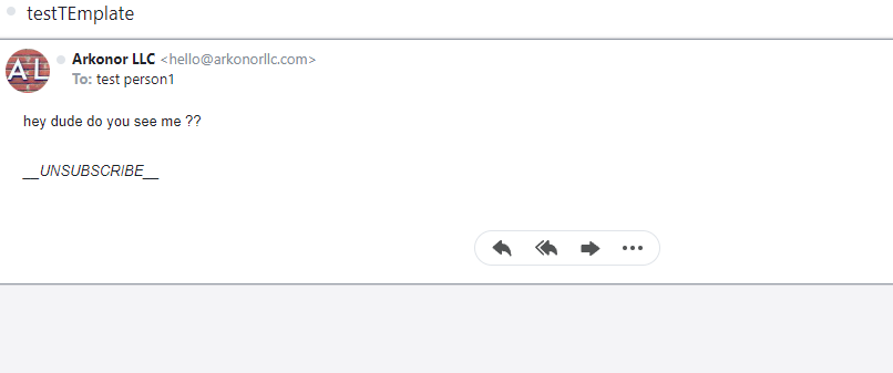

I’m missing something and it’s probably something simple. I created the template and added the link

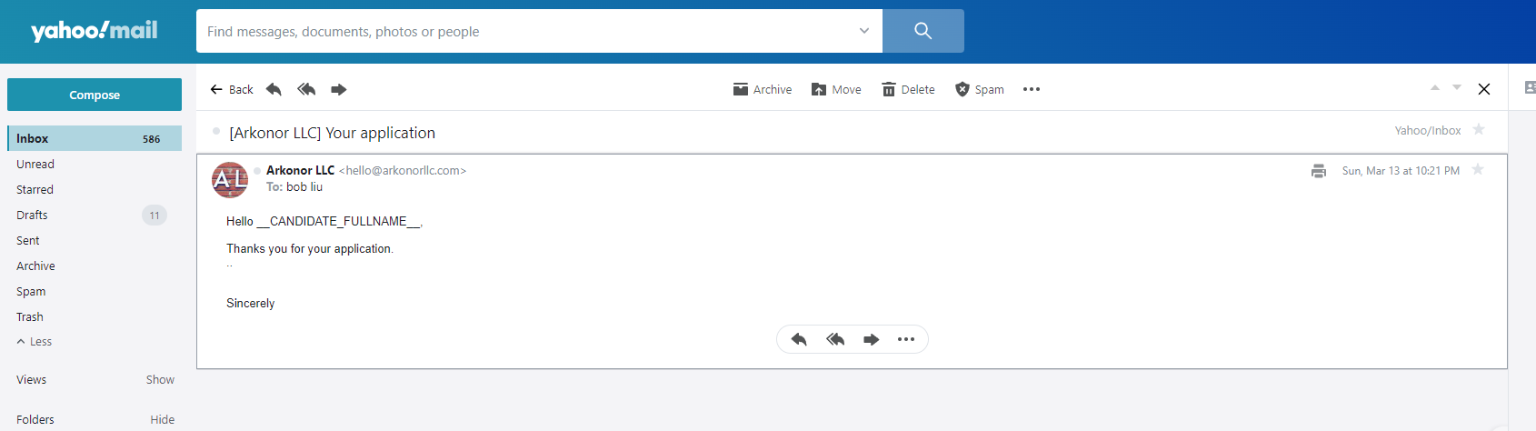

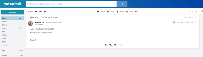

And then I would send the message to them and this is what I got:
this result
hey dude do you see me ??
UNSUBSCRIBE

Hi
So , when you revice that mail , is " UNSUBSCRIBE " a link or just a text in your mail box ?
Hi
What mail software you use ?
Outlook ? thunderbird ?
Have you tried earlier dolibarr version before ? Like 14.0.3 ?
What is the source code of the link ?
__UNSUSCRIBE__
Should be in one sentence, not cut by Italic tags.
I tested this out on 14.0.5 and the reported issue occurs on my installation, too.
I am using version 15.0.0 the email was sent to my yahoo.com account. I tested some other codes and
i created an trouble ticket on github
please add to the ticket if you have the same problem
