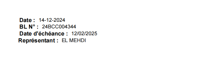

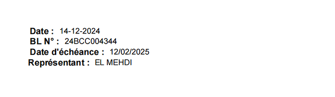

I want to add the name of the commercial (salesperson) to the following documents:
  • Devis (Proposal)
  • Facture (Invoice)
  • BL (Delivery Note)
Can anyone guide me on how to achieve this? Specifically, I’m looking for instructions on how to add a custom field or attribute that will display the commercial’s name in these documents.
Any advice or steps to do this will be greatly appreciated!
Thank you in advance for your help.
Hello, maybe try to define this constant to 1 in Setup/Other menu : DOC_SHOW_FIRST_SALES_REP
