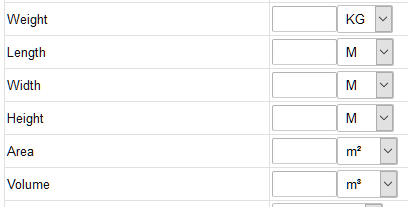

Hello All,
Currently, all new products default to ‘M’ as shown in the picture. We mainly use ‘CM’ for length, but I can’t seem to find where to change the default setting.
I looked into: \product\class\html.formproduct.class.php
I am guessing this line is responsible:
else if ($measuring_style == 'size') $measuring_units=array(-3=>1,-2=>1,-1=>1,0=>1,98=>1,99=>1);
If I change 0=>1 to 0=>-2 nothing happens on the new product page or the edit product page.
Can anyone help?

You were very close aljawaid. I’ve managed to set the default values (I use G and MM). I’ve edited two lines (changed 0 to -3) as per below
function load_measuring_units($name='measuring_units', $measuring_style='', $default='-3', $adddefault=0)
function select_measuring_units($name='measuring_units', $measuring_style='', $default='-3', $adddefault=0)
and it worked for me. I hope it’s going to work for you as well. Good luck
That worked for my ‘CM’ default values, but it changed my weight to ‘MG’ instead of 'KG. Also my volume won’t change to ‘LT’

I was playing with the code but I haven’t managed to set it up as you wanted (KG and CM) but I’ve used a default value for CM (-2) what in my case is a 50% win as I use now KG and CM. I hope someone will find the way to set it up separately.

Solution for today’s day is:
In the Home->Setup->Other setup add MAIN_WEIGHT_DEFAULT_UNIT and set it to 0 (0=kg, -3=g, …) then in \product\class\html.formproduct.class.php edit two lines
function load_measuring_units($name='measuring_units', $measuring_style='', $default='0', $adddefault=0)
function select_measuring_units($name='measuring_units', $measuring_style='', $default='0', $adddefault=0)
and change them to
function load_measuring_units($name='measuring_units', $measuring_style='', $default='-2', $adddefault=0)
function select_measuring_units($name='measuring_units', $measuring_style='', $default='-2', $adddefault=0)
The outcome is that your default values are set to kilograms and centimetres but please note that Area will be set to dm2 and Volume to mm3
