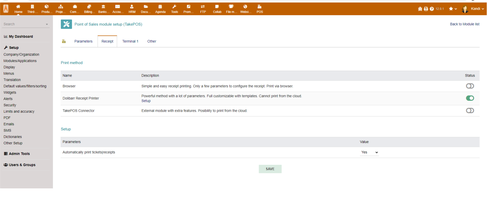

Go to the TakePOS module, click the Settings button, and then go to the Receipts Tab. You can set up your receipts there.
To configure the printer, you only need to do that if you select the Dolibarr Receipt Printer option; otherwise you can print to your printer from your browser.

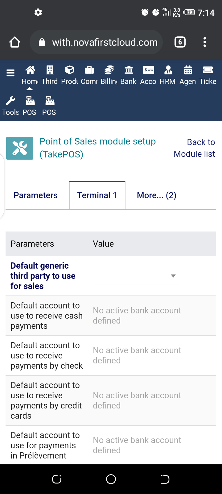

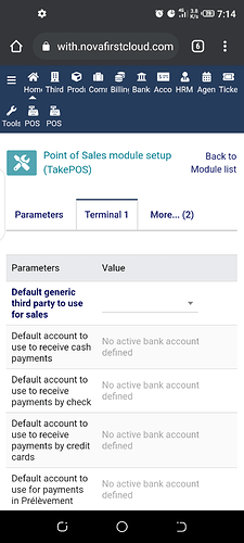

I am implementing Dolibarr 12.0.3 with TakePOS module connector and I want to configure a thermal printer to print tickets with TakePOS but I haven’t i cant do that. If any one can help me on settings of it, what are the meaning of the parameters fields,?
And does it simply find the printer with out pointing to the receipt printer?
Thanks in advance for your help
You can use TakePOS Connector that is a local plugin for the thermal printers and others.
http://en.takepos.com/connector/
