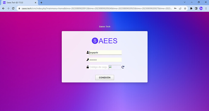

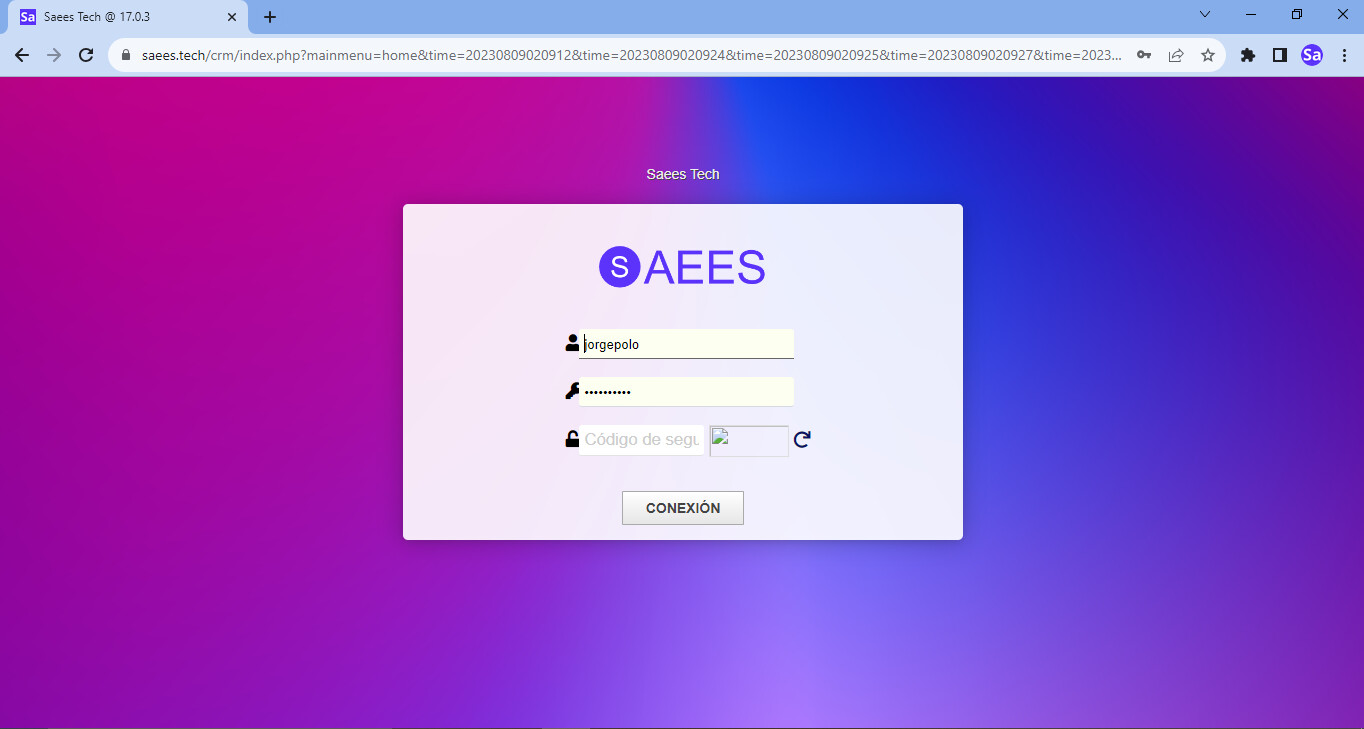

HOW TO DISABLE THE CAPTCHA CODE SINCE IT DOES NOT ALLOW ME TO ACCESS THE IMAGE OF THE CODE DOES NOT LOAD UPDATE TO VERSION 17.0.3
Hi I need HEEELLLPPPP please.

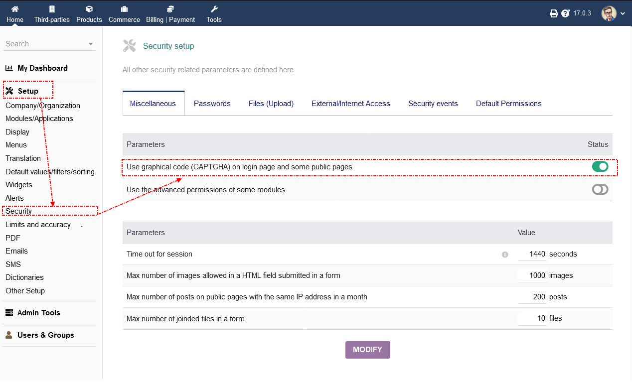

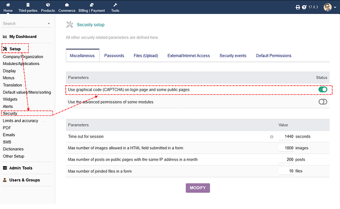

Go to - SETUP–>Other Setup, try this constant
MAIN_SECURITY_ENABLECAPTCHA =0

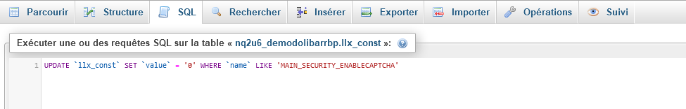

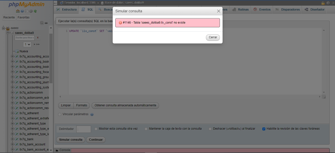

Use PHPMyAdmin and SQL Card
UPDATE `llx_const` SET `value` = '0' WHERE `name` LIKE 'MAIN_SECURITY_ENABLECAPTCHA';

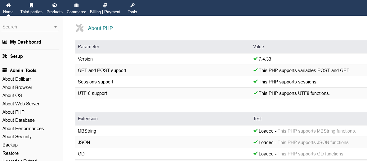

Re Upload your version 17.0.3 and check if PHP GD is ok in “About PHP”

I did the query as indicated but it appears that this table does not exist.

your database prefix est llx7q, good syntax is
UPDATE `llx7q_const` SET `value` = '0' WHERE `name` LIKE 'MAIN_SECURITY_ENABLECAPTCHA';

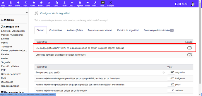

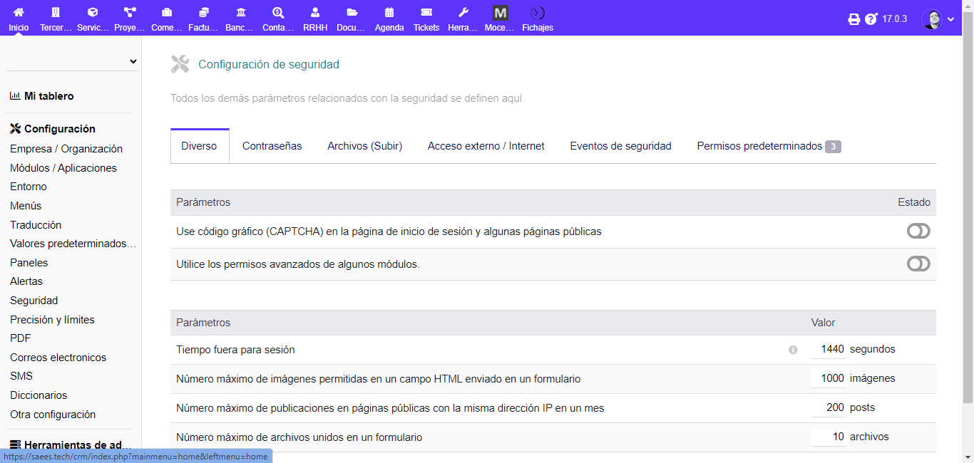

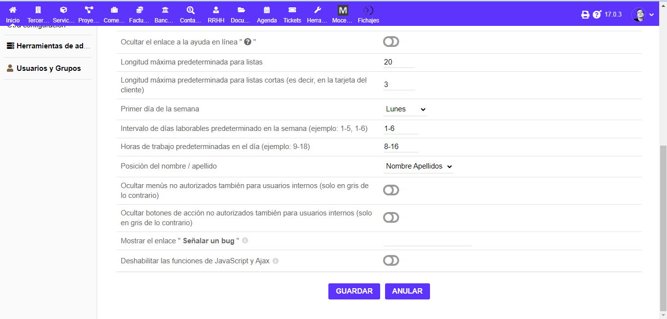

Hello, I was able to enter Dolibarr but now I have functions that it does not allow me to modify, for example when enabling options in the environment, such as hiding menus from non-administrator users, how to re-enable the captcha code, among other functions, I do not know why this is due.
See here :
