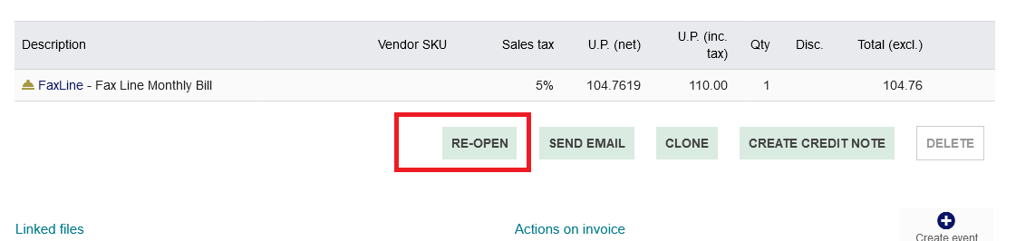

Two things you can do, 1. delete the payments applied then You can re-open the Invoice, 2. You can delete the payments and delete the Invoice and from the P.O. you can edit it from there in Create the New Invioce.
Actually after v14 you can delete entries from accounting journals and then you can delete a payment and then you can modify an invoice
