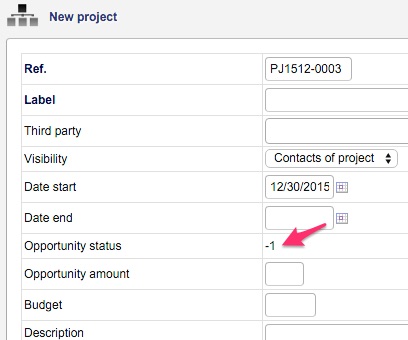

Guys, I have Dolibarr 3.8.2 installed, I have noticed that i have an error in the project section which i have no idea how to fix and i was wondering if someone can have a look at it and let me know what to do to fix it.
I have attached a picture of the problem if for help.
Much regards,
Fernando

Hi Woolfgang, nothing seem to be broken apart form the the (-1) in the project tab opportunity status field. I have set the project to to follow leads/opportunities. thus is a new function as 3.7 did not had it. I have notice too that this happened after the upgrade which was done through to and automatic script form Instalatron this facility is use by my web host to install all sort of web software.
i have no problem with logging in and everything else seems to work ok but i can’t select the opportunity status see picture.

hi fernando,
i have seen your picture, so i swiched in my installation (3.8.2) to follow opportunitys and made new project. but i have a popup and not a -1, so i think you miss a table where the values for the popup are inside. i’m new to dolibarr but when i make a select to a empty database or a non exististing table i get a -1 as result. if this is so, your update did not generate this table and your popup is empty (or -1) i dont know.
do you have access to the database ? fo example phpmyadmin ? if we search the code and can locate the missing table, i can send you the content or a database-dump of a nearly new installation… i have no better solution…

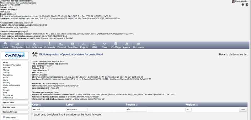

go to setup -> Dictionary setup - Opportunity status for project/lead and look if there are some entry’s
i switched all off and after this i had a disabled opportunity-status when i create a new project, but i have not -1, it’s empty. so i think you have no entry, please add one and reply to me

I had a look at your last entry in which you ask to have a look at the Dictionary setup - Opportunity status for project/lead and there is nothing there. I have installed a new copy of Dolibarr on my web host and i have compared yes there are missing all of the entries. I have tried to add them but i get and error as you can see in the attached file.
I have access to mysql admin within spannel which is what my service provider allows but i dont have command line. i could add the fields but i dont know what to include see attachment file.

hi fernando,
i can not read the error in your picture, the resolution is verry low. but i think it’s like i think.
the top-error tryes to attach the database-table (i think it not exist, but i can not idetify the error in the lousy picture)
the second error is (i think but my eyes are not from jesus) is to insert into a table that not exist
so send please a better picture then i can have a look (or you self) to the database
search the name of the database like llx_name_i_dont_know_but_should_be_in_errortext if it exist, if not your installation did not create
how did you install ?? are you on mac ? there i never did anything, so install apache and copy the zip-install (extracted) to the apache server and try again.
but first look for the missing table (the name in the errortext i can not read)
