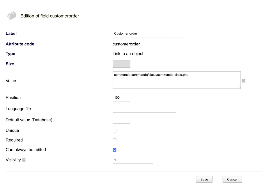

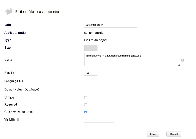

In Supplier module setup -> Complementary attributes (orders) add a new attribute in the same way as on the attached image
the value is [code]
commande:commande/class/commande.class.php[/code
It worked!! Thank you for your help!!

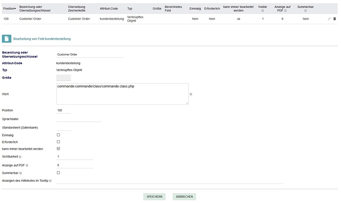

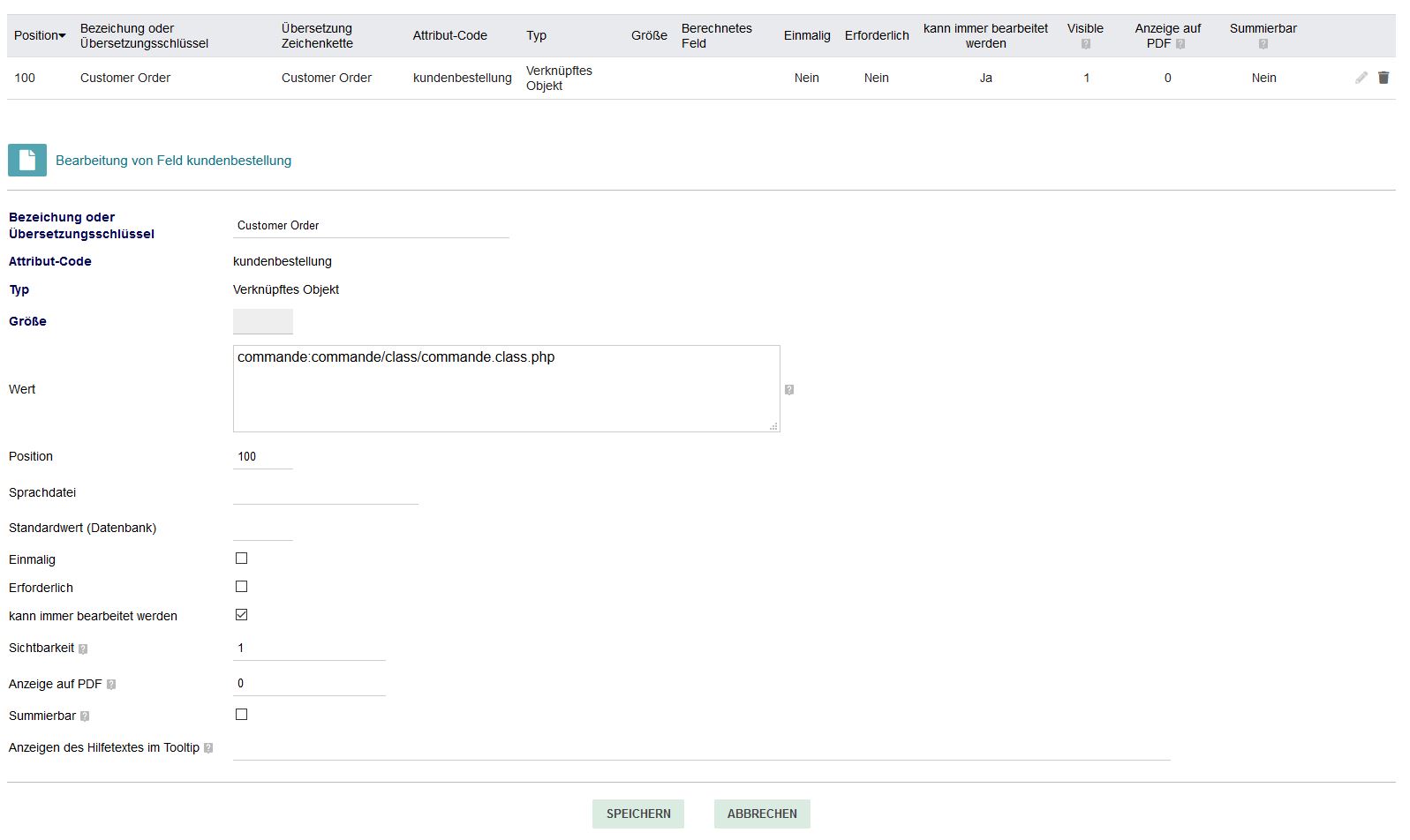

I did it as described.
Unfortunately, the drop-down menu does not offer me any customer orders to choose from (see pic1)
do you have an idea why
Pic1: https://i.ibb.co/Hhvr66n/order.png
My Config in Complementary attributes
Best regards,
user
I just tried it on version 12.0.1 and it worked…
everything looks correct apart of “kundenbestellung” which should be “customerorder” change it and it should work.
