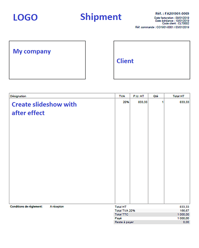

Please i would like to know how can i make shipment model like invoice.
See the secreenshot in attachement
Thank you.

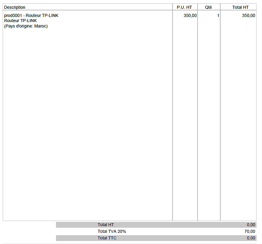

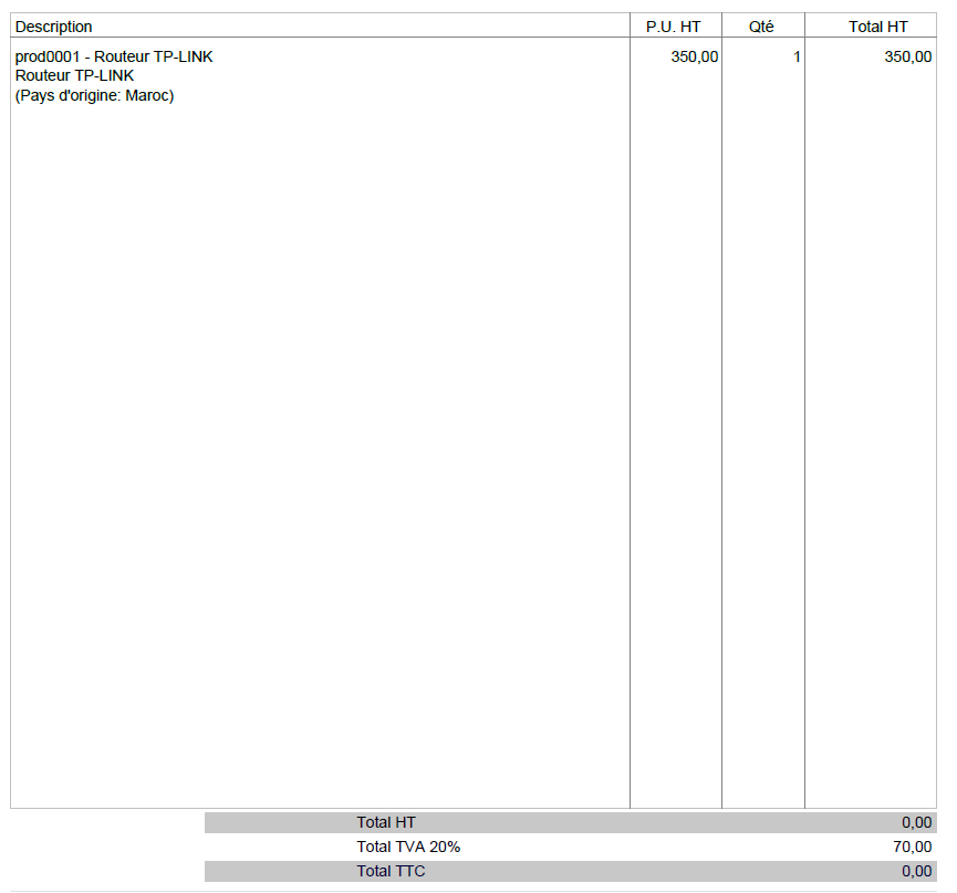

Hi again Mr Peter A. Gebhardt,
Yes i will do, but my solution works only in version 8.04 but in version 3.9.1 i can’t get total HT and Total TTC i got just total VAT, please how can i fix it?

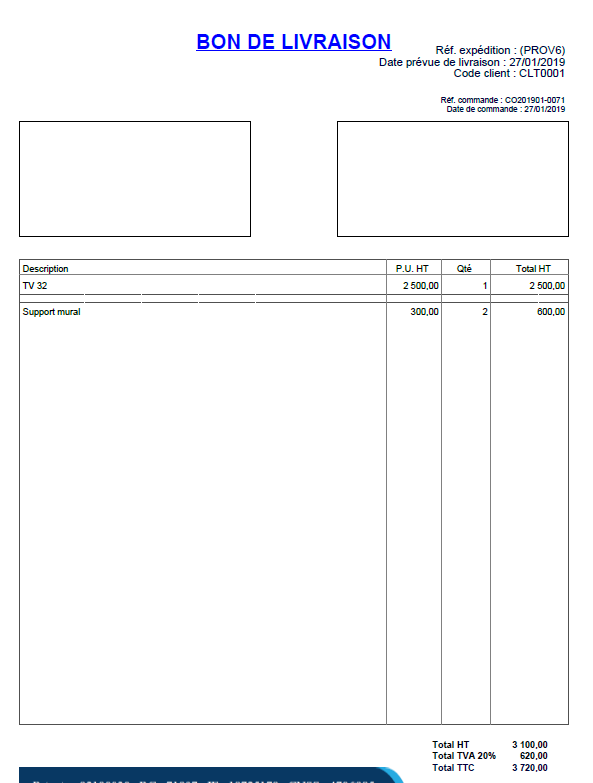

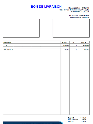

I fixed this problem on old version 3.9.1 i changed the place of code, i put it in the function _pagefoot

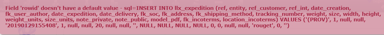

Now i need just how to add also services to expedition, i used this variable : STOCK_SUPPORTS_SERVICES= 1
But i got error Message :
=====================Error Message ==============================
I fixed it
Thank you
