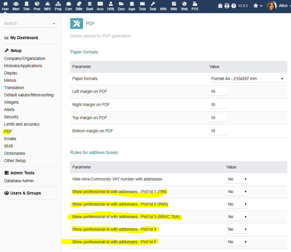

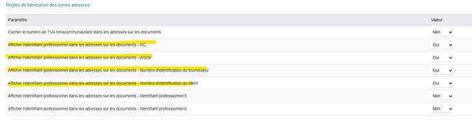

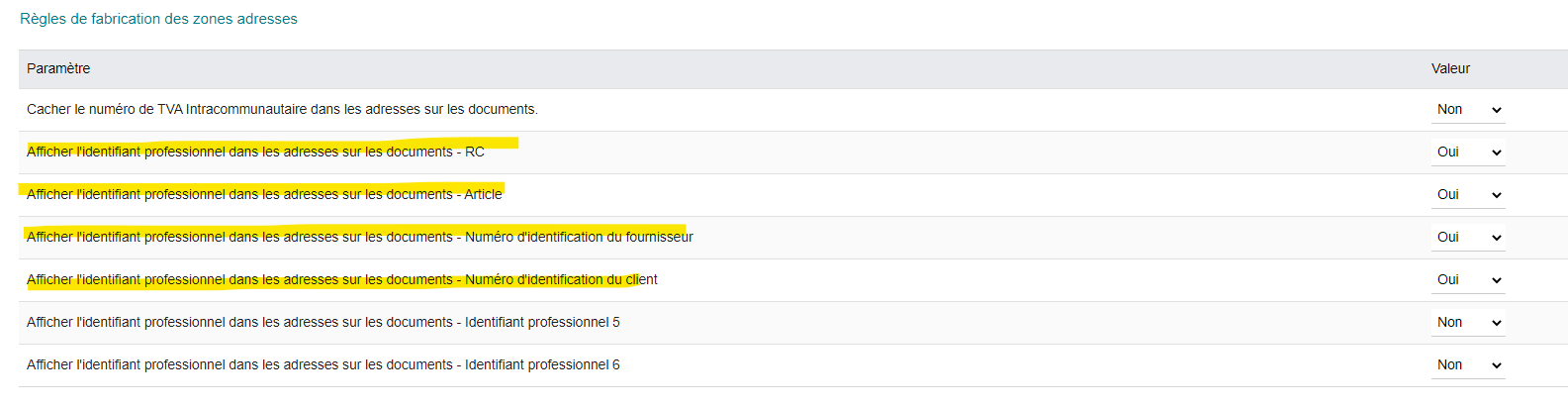

I found a solution in french forum, it is not complicated, you have to activate flag in PDF parameters, “Configuration --> PDF”
Hope this helps
Dolibarr 12.0.3 Could

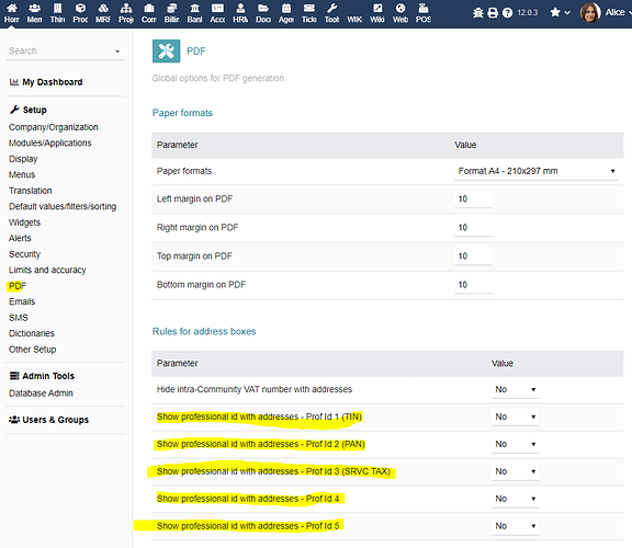

An English screenshot :
Thanks for English screenshot,
Regards
