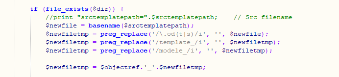

in core/modules/propale/doc, the script doc_generic_proposal_odt.modules.php contains this code that permits to rename the file result name …
Good continuation
Thank you for the support, I did try the “template_.odt” and it worked but it’s adding the ‘_’ after the mask.
Secondly, if I have more than one template for the proposal, how can I rename multiple template files which should not add the template name.
Can we disable or modify this function to achieve the goal?
you can do it, by changing the php script…
add a new line just after the last line in the portion of code of my last post
  • $newfiletmp = $objectref;
Good continuation
Thank you so much, adding your code line solved the issue. :slightly_smiling_face:

I am trying to replace the odt document name to have my Project title in the place of the odt file name. Can you show me how to incorporate {object_project_title} into this line of code?
$newfiletmp = $objectref . ‘-’;
